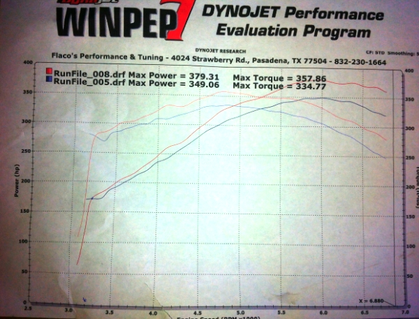

here is my dyno graph before the fuel pump.
Looks like peak torque is at 4700 rpm. I tried a wot stomp last night but i had a little tire spin, so i wasnt able to tell were my stall rpm is. I did run into an ls2 gto on I10 and put a couple cars on him! I got a thumbs up from him and i can tell he was surprised.

Cool, so for this setup, a perfect 100% drag torque converter shoudl stall at 4700rpm. I dont think you'd like driving that on the street though.
All depends on what you are comfortable with. There are guys that drive 3600 stalls, even 4200rpm stalls. But its up to you, and how much you can hook.
