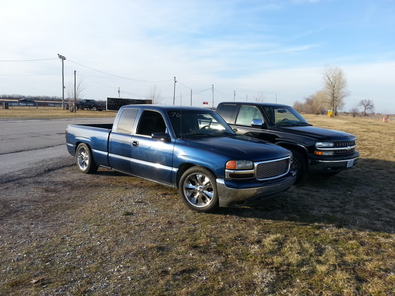

took my truck to the track for the first time today, kinda suprised by how it runs, granted its not fast by any means, but im impressed
my best pass was 15.05 @ 93.59 with a 2.39 60', if definantly needs gears and a convertor, shifts into 3rd bout 30' before the end.
truck is a 99 ecsb 5.3, shorty headers, stock replacement magnaflow muffler, built tranny, tune, stock air intake with a cut box, running on 20" wheels and 275/45 tires, has 3.42 gears
im planning on putting a set of 4.10s, 3000ish convertor, and a different muffler, id like to get the truck down to the low 14s, would that be possible the gear/convertor swap?
