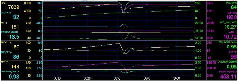

Looking at my logs, the throttle rev limiter was kicking in on each run that I was in Performance shift mode. I had the shift points set to 6500, but it was overshooting to 7000, maybe it would have been more, but my throttle rev limiter was set to 7000. At each shift you can see the throttles close down to 50% and then return to 100% over a period of .35 seconds. On my first and last runs, I ran in Normal shift mode with a shiftpoint of 5800..overshoot only went to 6000.
Here's a 1-2 shift. (tune is scaled 50% to keep the airflow values within the PCM limits)
