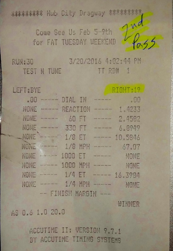

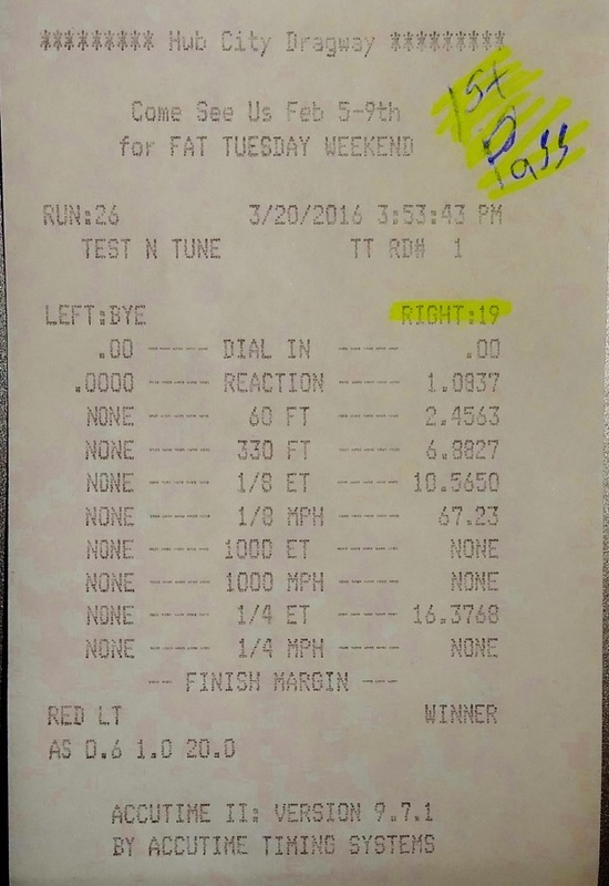

Finally was able to get to the track for a couple of passes. I wasn't worried about the reaction time, so pay that no attention.
My truck is a 2004 crew cab Z-71 4wd with the 5.3L, 4L60e, and 3.73 gears. Here are my modifications,
Black Bear Auto-Cal tune 91 octane +
Airaid M.I.T.
AEM dry panel filter (oem/factory type)
Magnaflow 3" SI/SO, 14" case muffler
I made both passes with a full tank of gas. Truck had no "weight saving" mods. Temperature at the time of the passes was 61*F.
First pass leaving off of idle,

Second pass I stalled it up to 1,200 then hit it,

Your trap is WAY low just not making any power. I understand its a CC but my stock RC ran 72 in the 1/8th. Probably contact BB or get it retuned if I were you. Somethings just not right.

My truck was factory rated at only 295 HP & 335 torque in stock form. I believe yours is rated a decent amount higher. Do you know what the factory rating is?
Out of the mods that been done to my truck, I consider the Black Bear Auto-Cal tune the major one. I wish I would have taken the Auto-Cal with me so that I could have run it with the stock tune against the 91+ octane sport tune to see what the difference would have been between the two in the 1/8 & in the 1/4.
I don't know why the trap speed was working for the 1/4 mile portion. I wish I knew what it was running.

That was my 2005 and it was the 295 hp. 2wd RC ran 9.84 @ 72 mph with 3.73s. It was bone stock down to the factory 17 wheels and tires. No mods ~ 45-4550 lbs. My 07 was RC 295 hp 4wd Z71 and 3.42s. It ran 10.39 @ 69.xx bone stock ~ 4800 lbs.

What do you think my truck should be running in the 1/8 or 1/4 with its current mods of Black Bear Auto-Cal tune 91 octane, Airaid M.I.T., AEM dry panel filter (oem/factory type), and Magnaflow 3" SI/SO 14" case muffler?
The only thing close to a baseline that I have is that 2004 Car & Driver article that showed a Silverado Z-71 identical to mine (same gears, engine, trans, and even tire size) that ran a 1/4 time of 16.8 sec.
How much of a difference should I expect from the BB Auto-Cal 91 octane tune?
