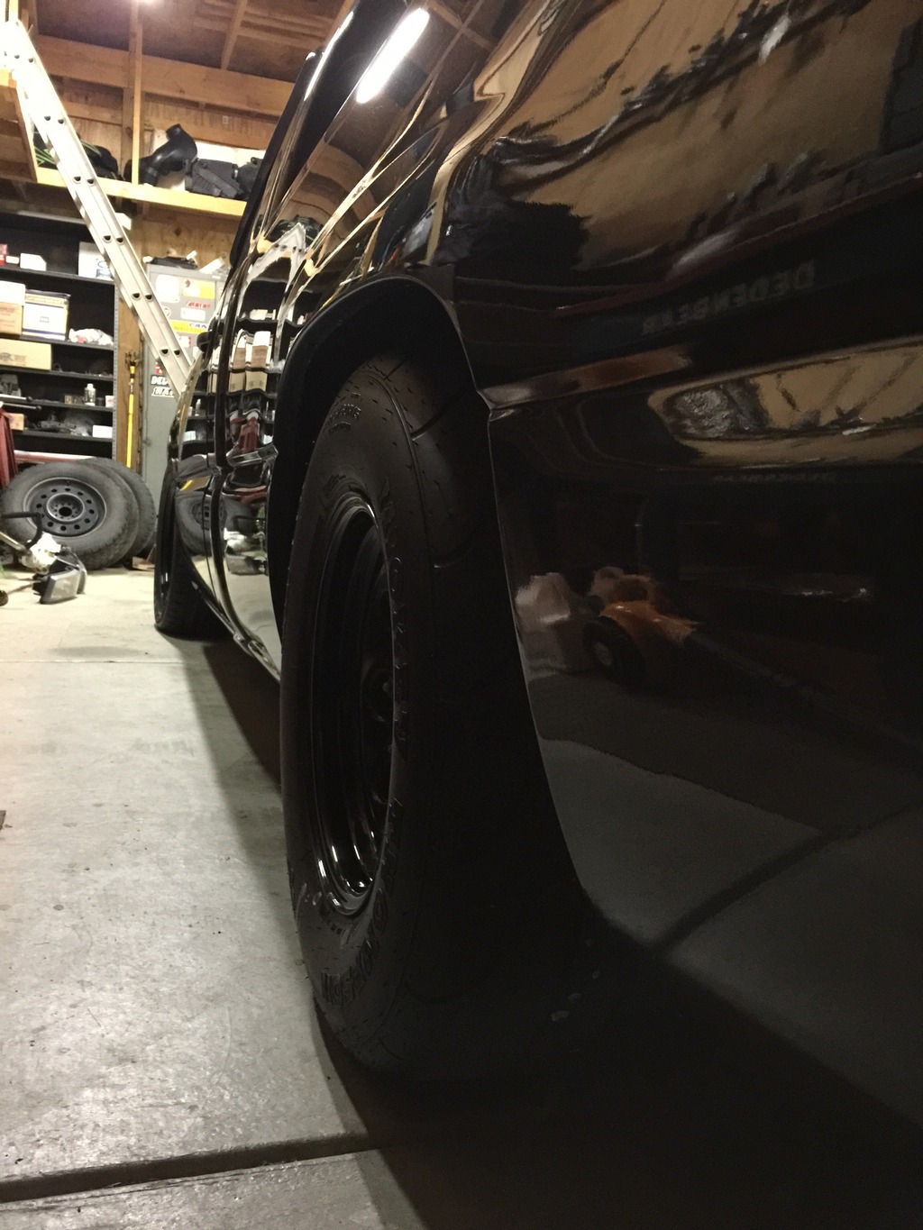

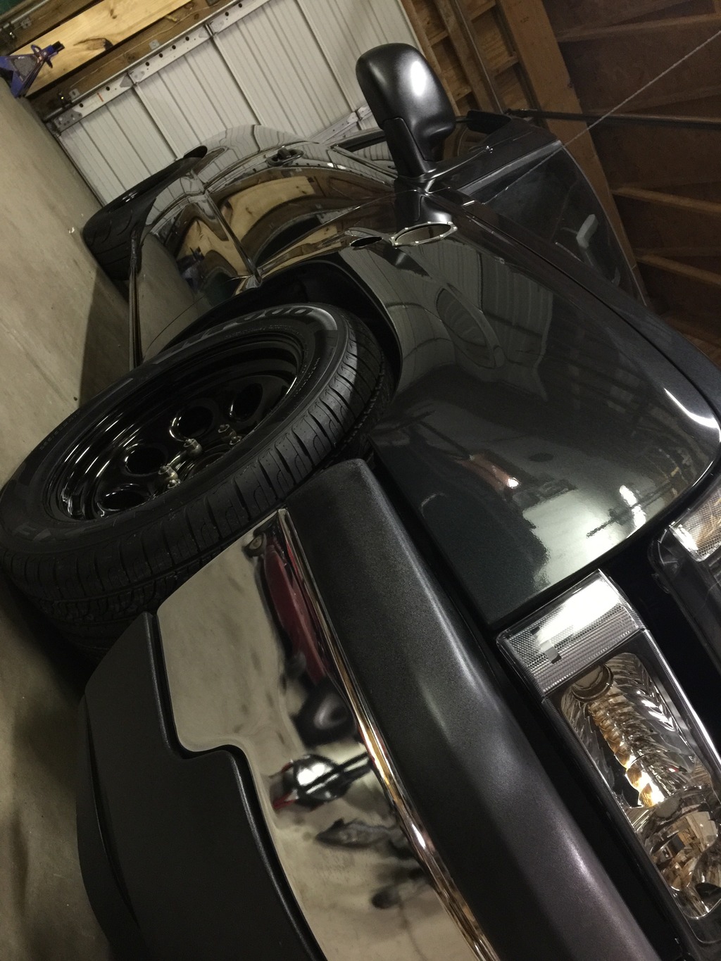

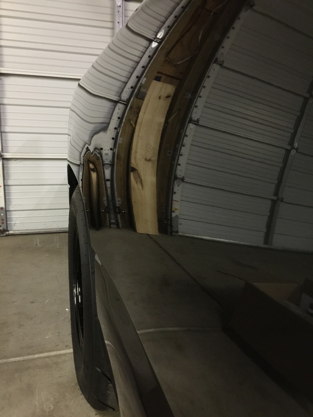

Hey guys I apologize for the delay I'm currently deployed so I don't have much time to keep up with the site but here's a few pictures. I ended up going with a 275/60 instead of a 315 which would have most likely fit with a little persuasion but that big a tire would've hurt more than anything. Unfortunately I didn't get any pictures of the wheels without tires mounted but as you can see they fit great! Also got the front end PTM!!

Damn that looks good, I went with the 15x8 on mine with a 275 and it bulges past the bed a little.
Thank you I'm very happy with how well they fit. For what they cost if you ever want to try the 15x10s at least you know you won't have to break the bank doing so haha.
