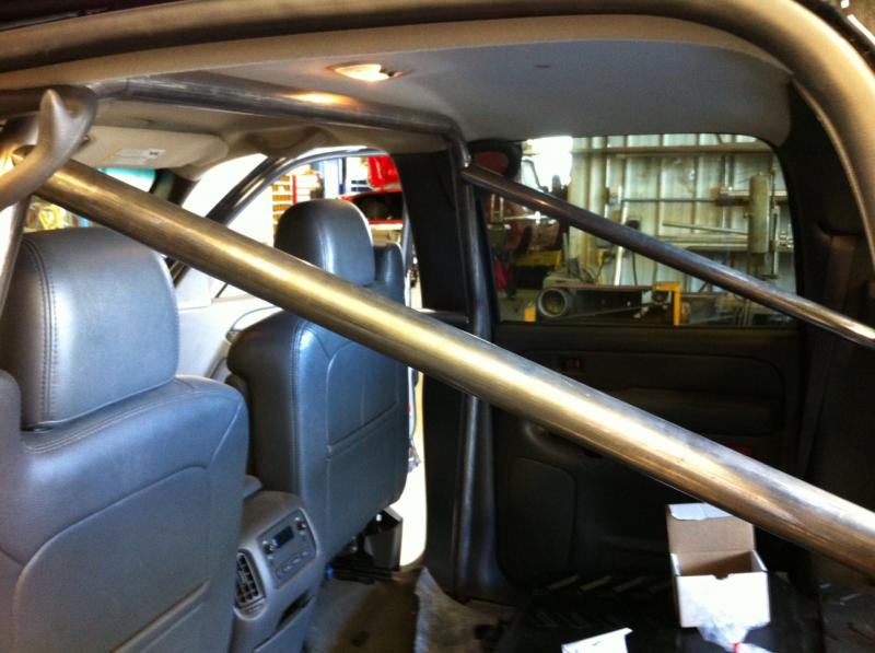

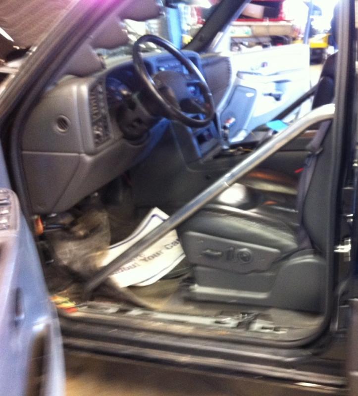

Old Jul 4, 2014 | 08:13 PM
DrX's Avatar
DrX
Joined: Jun 2005
Posts: 2,703
Likes: 6
From: Canada

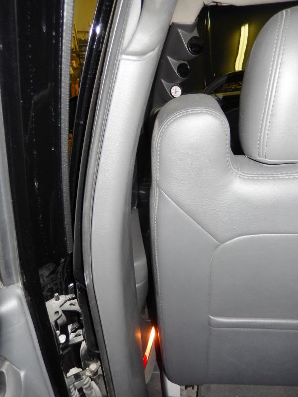

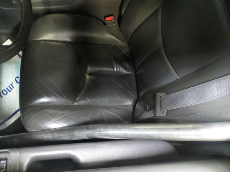

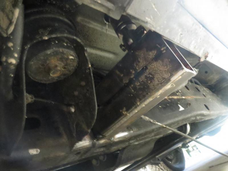

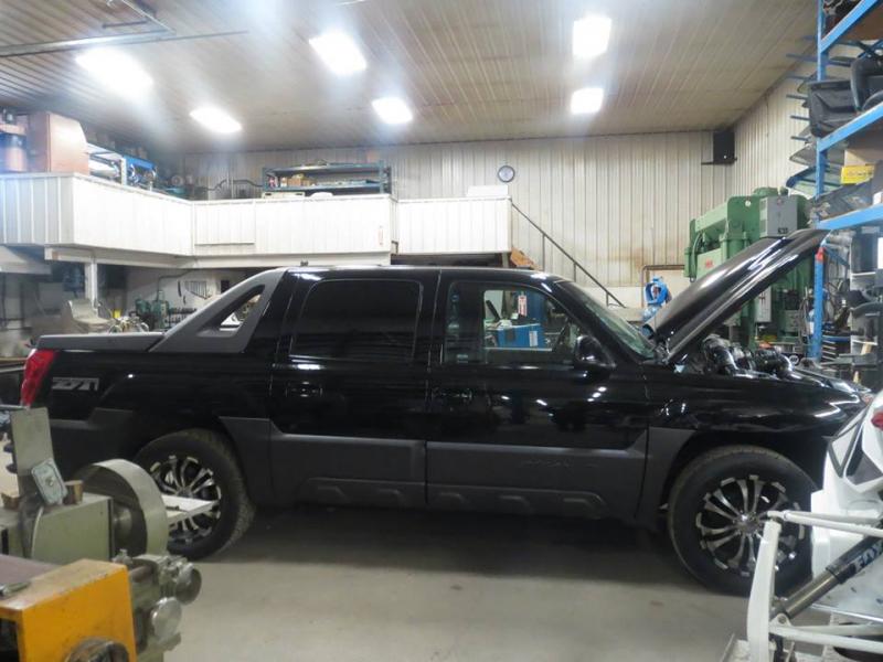

Definitely a squeeze to get a bar in there....particularly with factory door panels.

Old Jul 4, 2014 | 11:35 PM
GREENSIERRA's Avatar
Joined: Mar 2006
Posts: 1,092
Likes: 69
From: Canada
you got it done!!!
is it still at Sandale?
Old Jul 5, 2014 | 07:17 AM
custm2500's Avatar
Ph.D. in HUBRIS
Joined: Mar 2009
Posts: 4,087
Talk about a sleeper!
Old Jul 5, 2014 | 08:54 AM
DrX's Avatar
DrX
Joined: Jun 2005
Posts: 2,703
Likes: 6
From: Canada

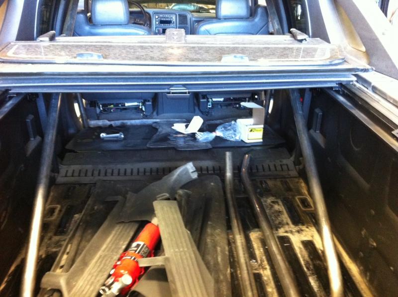

Originally Posted by GREENSIERRA
you got it done!!!
Still in progress....

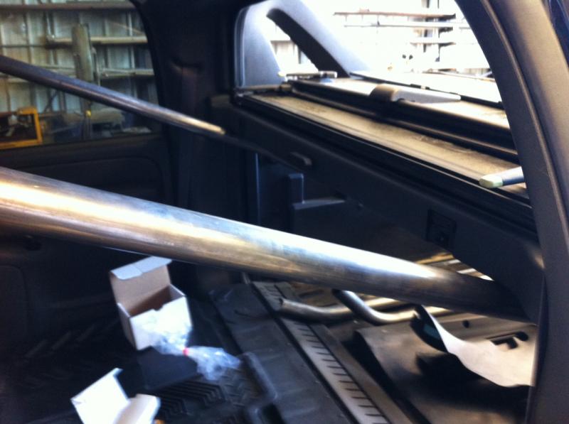

I don't think the main hoop and rear bars will be too noticeable through the factory tinted side glass if painted black. Top of the midgate will have to be notched to keep the rear bars inside.
