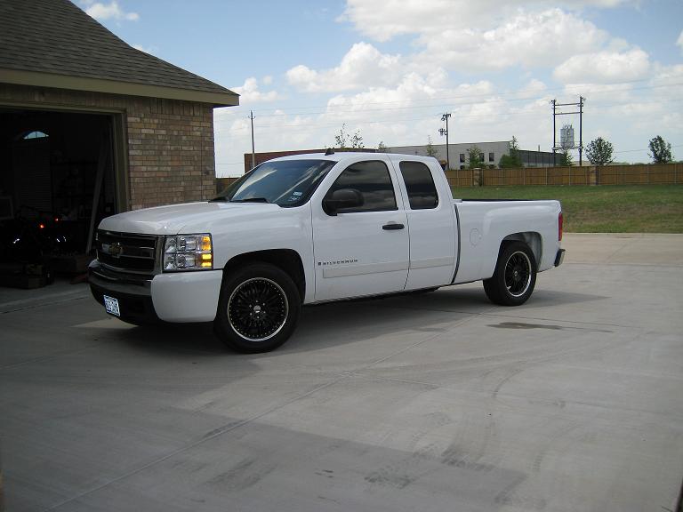

It has a 2 maybe a 6 drop with no overloads in the back. No suspension mods other then that and its just a 2 wheel drive.

2.. maybe 6 drop? Got a pic? that's a big difference. And I'll agree. cut off the bump stops and buy or make Caltracs.

Lets see if I can do this......

that looks like a 3/6. Nice truck.
