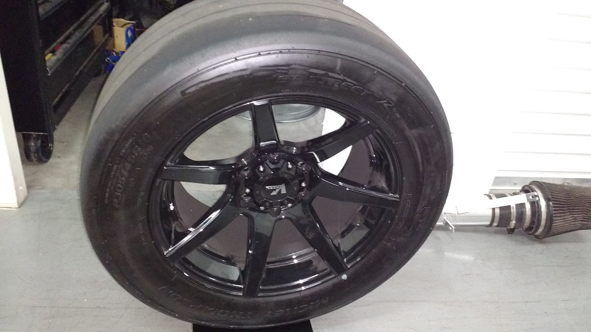

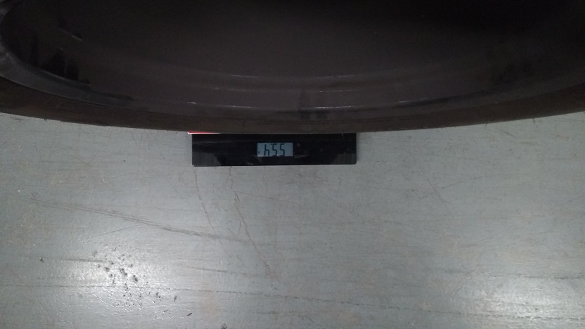

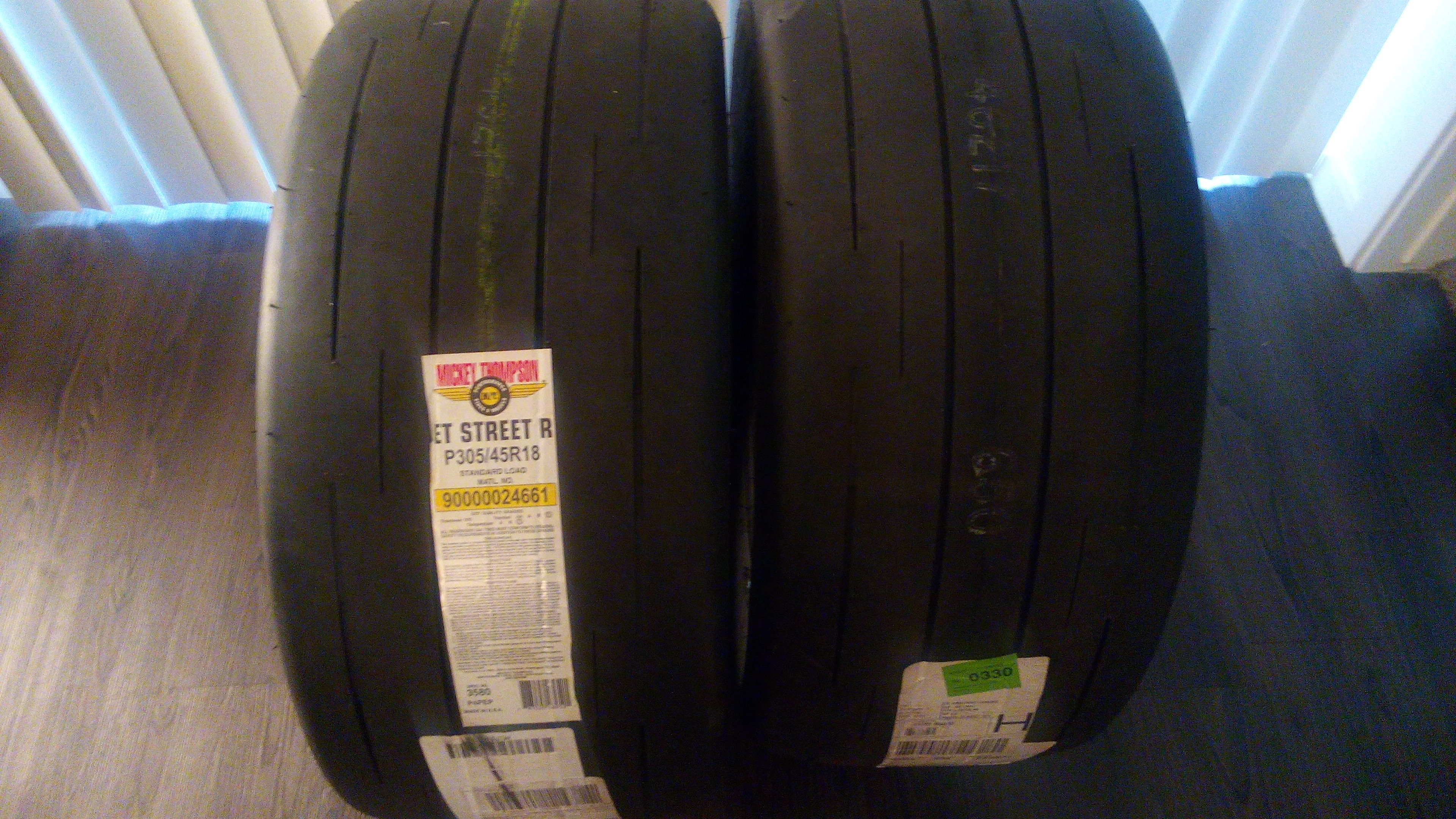

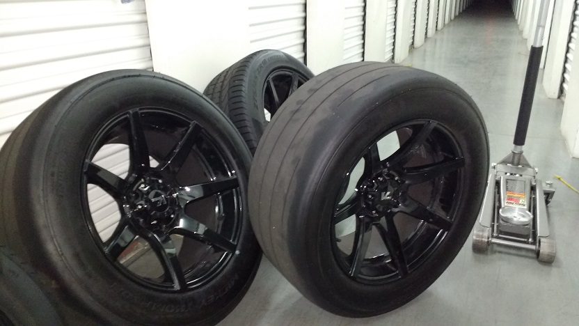

You guys finally motivated me to drop some stuff off at my storage unit today. I took my scale and some pictures with the rest of my crap. Also a pic of the tires when new.
Mickey 305/45R18 street et R on 18x9.5 v-rocks. 55.4lbs not sure if thats good or bad for a drag wheel and tire combo.

It's lighter than the stock 20's by about 30# at least. I would be curious what a stock 17 and 265 weighs.
