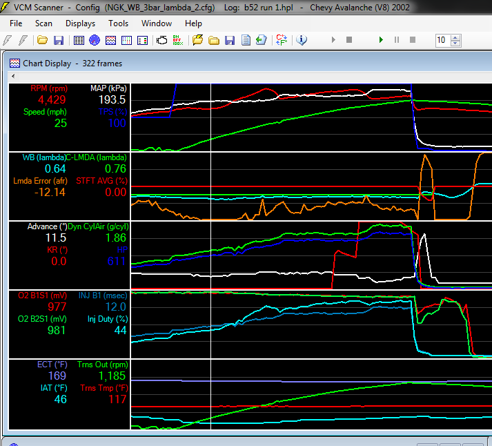

Heres a pic of a log and you can see what I mean
Notice the rpm actually drops after I launch initially (red line in the top section), but wheel speed is obviously increasing (green line bottom section). Also notice the knock at the 2-3 shift. Its rich because of the meth, notice the intake temp
Yea looks like you had a fair bit of KR there towards the end of the run. Those IATs are nice though! Was that at like 4am or something?
And how accurate does that calculate HP? Looks like you're making somewhere north of 900hp if so!

Nope, 3:30 today, actual temp was around 70
Based on this equation which is based on my dyno time, very accurate. Calculators for et and mph also give me a 950+hp number.
The thing about that knock event...considering the amount of meth I spray, and the fact that it never does it if I am driving in 3rd and just lean into it, leads me to believe its false knock or just something banging around...but on the chance its IS real knock, I dont really want to tounch the knock sensor settings. However on a previous run I tuned out some knock and picked up 2mph.
