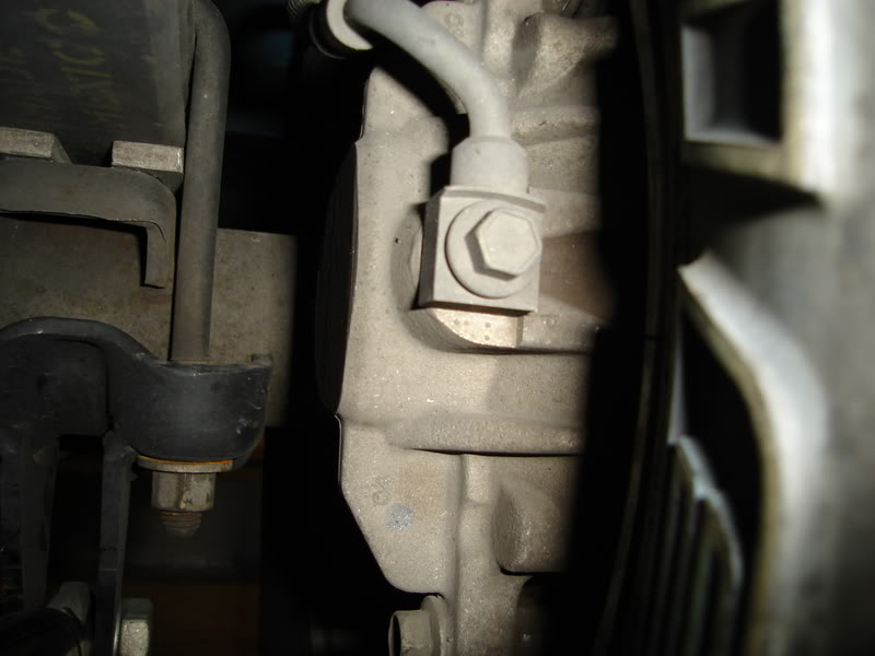

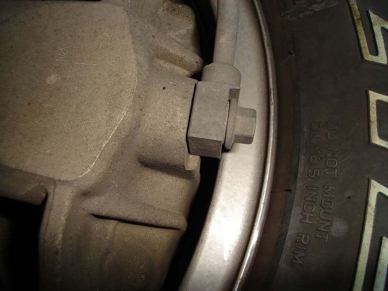

I found a wheel company that'll build me a (16 X 10 w/6.5 BS) cragar soft 8 style wheel for 150.00. And I can buy a matching 16 X 7 for the front . I'll add pics when I get it all done.
you still going to have problems with the banjo bolt. you will have to switch to an s10/blazer caliper with that much backspacing. this is a stock 16x7 rim.

Hey bluecajun5.3, thanks for the pictures. It looks like there is about an inch between the edge of the wheel and the bolt. Have you measured it? Is that a Tahoe wheel?
yeah it's around an inch. it's a stock silverado wheel.
