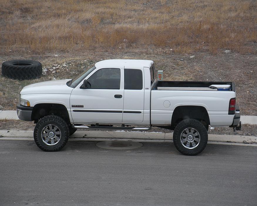

I have an 02 cummins i was wondering what all i would have to do to make 500 hp and have the whole truck be reliable even when pulling my fifth wheel it is an auto trans
