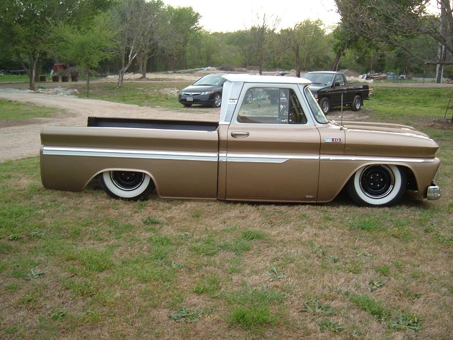

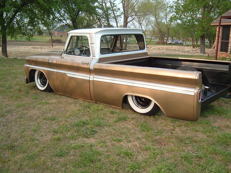

What color you going with on the truck? I have a 66 with the same Saddle Tan and White scheme.
I got some more pics gonna stay with the same color.https://www.performancetrucks.net/fo...1&d=1270607662

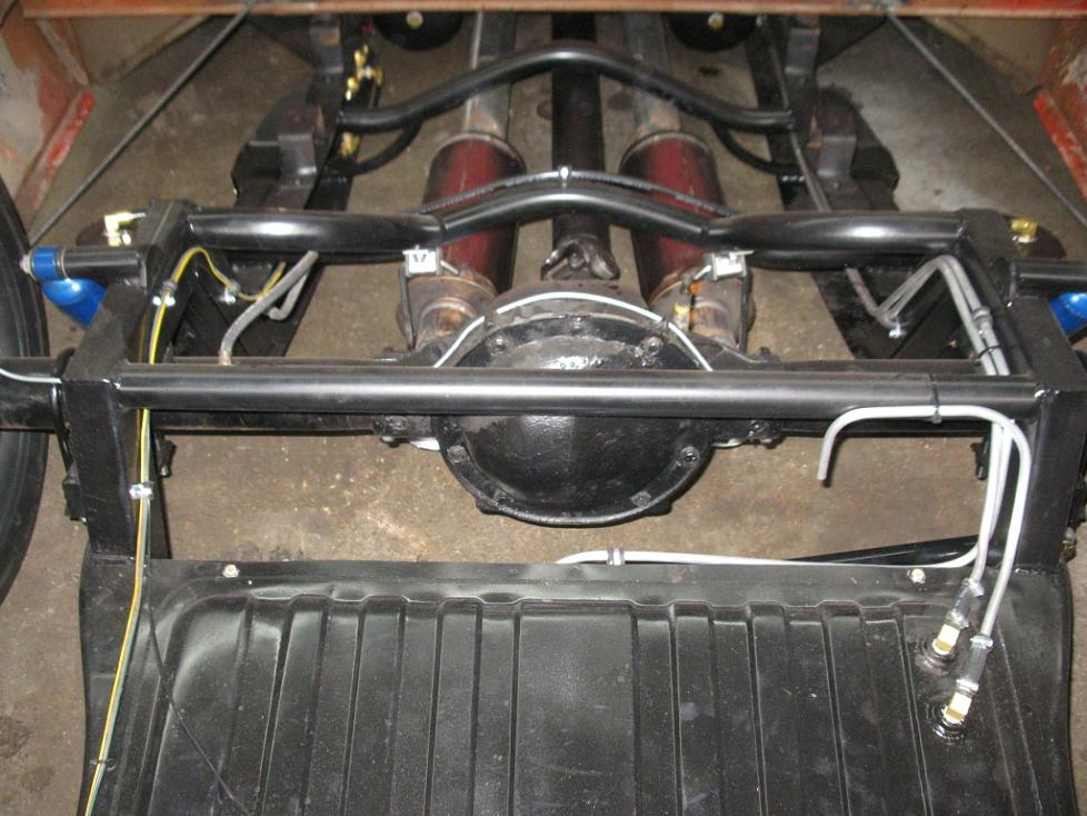

Is that truck airbagged to? What type suspension you using?
Truck is air bagged has has two link with c notch in the rear and the front is stock with drop spindles and coils removed for bags also had to fab lower control arm to get it this low.LQ9 swap in 65 Chevy c10-img23901.jpg
