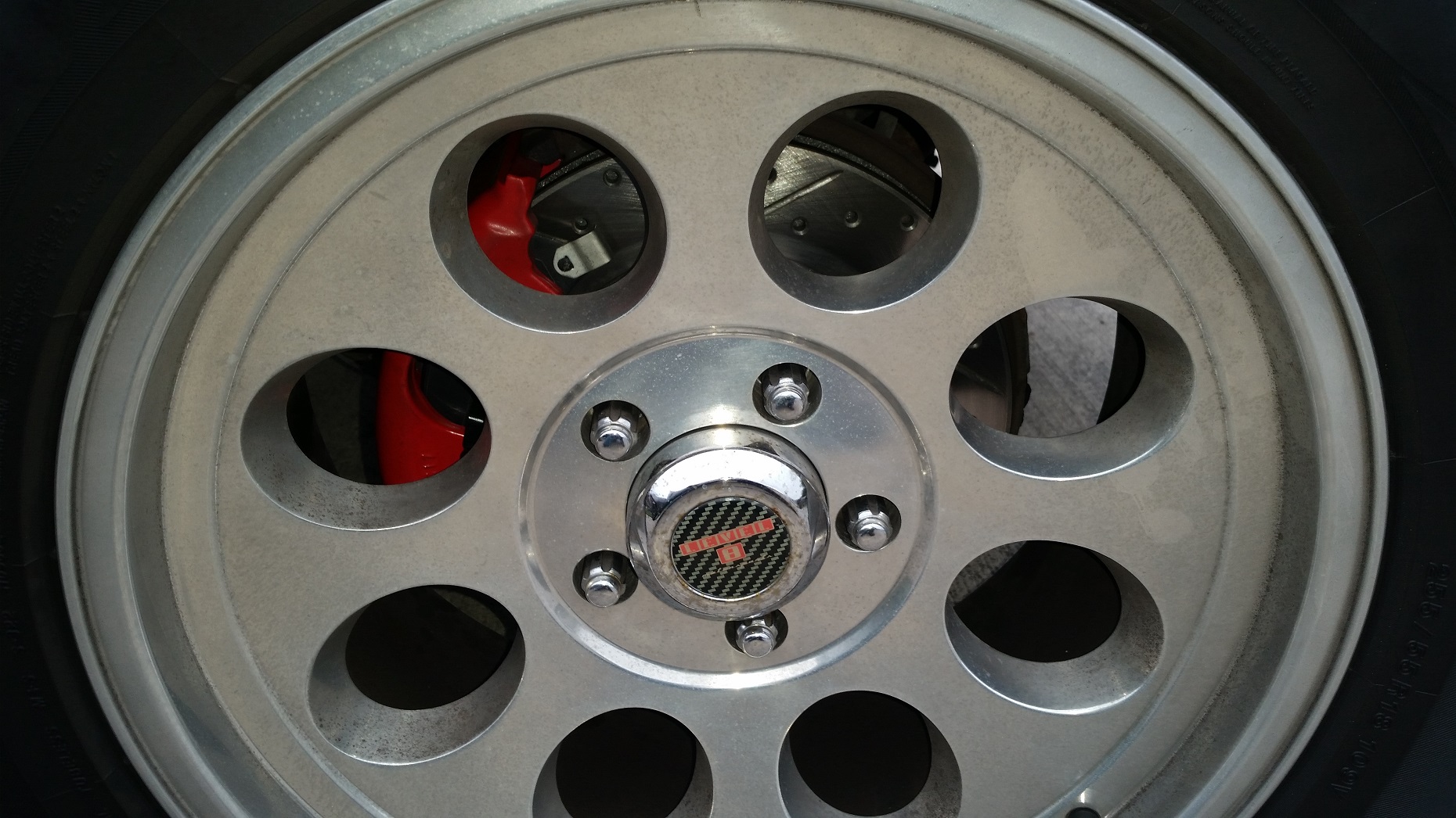

I just installed some PowerStop calipers/pad's and the summit racing rotors on my 1992 C1500. The performance is nice and they look great.
Calipers:
Power Stop Brake Calipers S4299 - Free Shipping on Orders Over $99 at Summit Racing
Pads:
Power Stop Z23 Evolution Ceramic Sport Brake Pads Z23-369 - Free Shipping on Orders Over $99 at Summit Racing
Rotors:
Summit Racing® Extreme Performance Cross-Drilled Brake Rotors SUM-BR-66011L - Free Shipping on Orders Over $99 at Summit Racing
Calipers:
what is the difference between these and the C2500 caliper? Anything other than red paint?
Old 11-29-2015, 08:49 PM
Pab's's Avatar
Join Date: Oct 2013
Posts: 16
Received 0 Likes on 0 Posts
No idea but I just wanted a clean bolt on look so I went with these.
