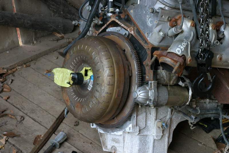

the tranny bolt pattern is the same for spacing, BUT your 4l60e tranny doesn't have the hole for the center top bolt and the 5.3 doesn't have the hole tap for the upper passenger side bolt. so, you will only have 5 bolts holding everything together.
just something to think about.
Edit: Just to clarify - this is a trans from the older V6 (Gen I, so to speak) - the newer V6 trans (GenIII types) should not be a problem as banker09 states below.

i have the 4.3 trans and converter behind my 5.3, everything bolted up fine...stalls about 1800rpm
oh and mine is an 02' that came with the 4.3
