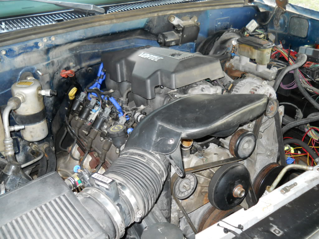

Here's some updated pics of my engine compt, still working on tiding things up under there. Had to install the factory clutch fan to drive around a little till I can make a trip to the junk yard to pickup another 16" fan from a 95 grand prix. Can't wait to get the twin electrics on this thing that stock clutch fans louder than the old school straight fan.
