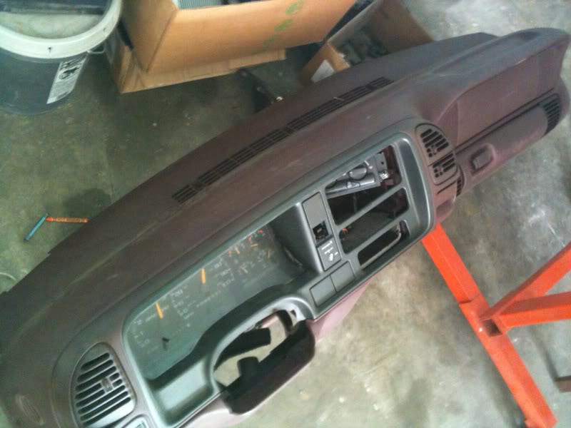

Well I finally got a chance to get some work done to my truck today. I installed the factory 5.3 air intake and maf. I also installed the 98 a/c ducting, painted and installed the dash complete with the interior wiring. Now I have to go our U-pullit and pull a set of 96-99 pedals so I can install the 98 steering column.
Here's the dash before:

Here's the after: I still need to go back to Orielly's and pickup a couple more cans of duplicolor interior paint so I can finish the dash trim and other interior panels...

It was a pretty big job (but well worth it in my opinion) but I changed everything the a/c box, wiring harness, steering column, dash and did all the painting you see in the pics. I still have the get the 98 brake pedal assy to finish the install. I'm updating all my wiring interior/engine controls up to the 98 then integrating the 01 5.3 engine control harness into the 98 so I can have all the 98 features fully functional with the exception of the airbags (it helps having acess to an entire 98 parts truck thats the same model as the one I'm building). I also decided over the weekend that I'm going to be installing a 3" body lift soon due to the fact my tires offset out 1" past my front fender and the front end needs to go up at least another inch to clear and it's already 1" higher than it was with the old cast iron/steel 5.7l and I'd have to install 2" blocks on the rear at least to level it out and then my Rancho shocks will be too short (I checked it out over the weekend)
