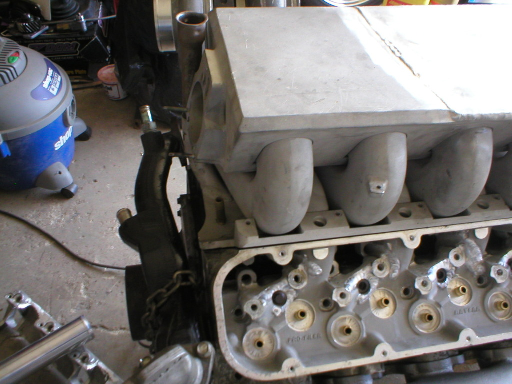

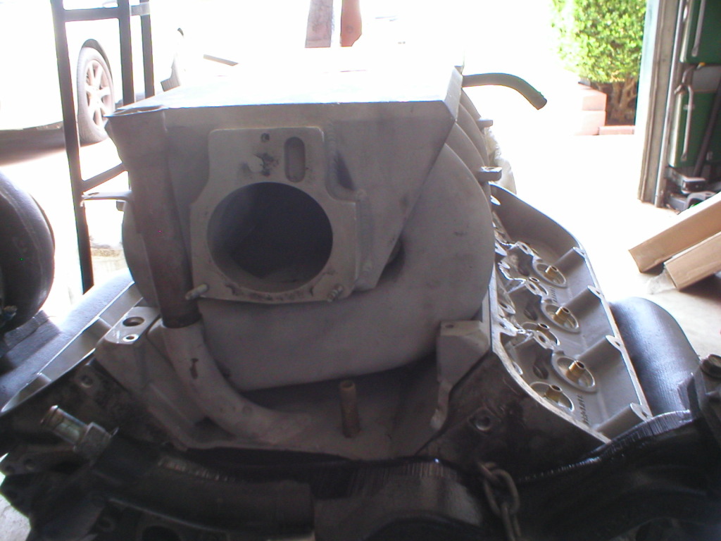

Yeah i got 2 different 8.1 builds going the iron heads are cnc ported by a company who did 85 sets of 8.1 heads for GM marine division. So when he heard I had an 8.1 build going on many moons ago he offered to do them for me since he still had the program
And more pics I got all the BBQ raylar stuff in one spot.

Whats with the intake? Them turbos are huge are you going to have any problems spooling them? They dont quite fit the manifolds either. Either way inspirational I wanna see how it all fits under the hood.

What do you mean whats with the intake?
yeah they are t6 turbos on a t4 manifold i got to make adapters so they are both level and bolt up. I am buying smaller exh housings and will probably put my tv81 compressors on there if they are bigger have to measure when i get home from deployment. 2 months to go. They should fit under the stock hood. the intake fits and it is taller then the turbos.

That is a raylar intake
