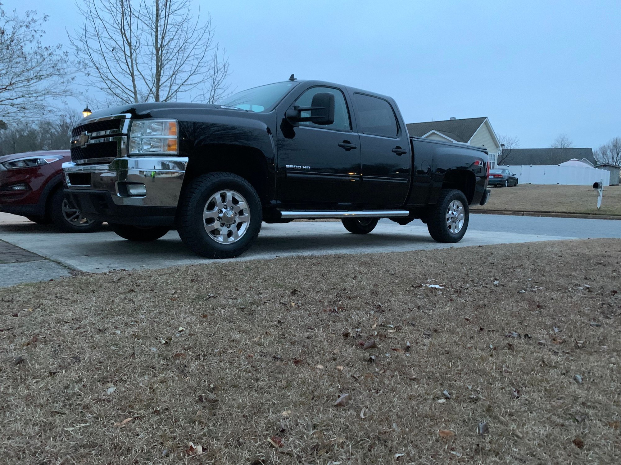

For starts I’d like to say from what I’ve read through this community everyone seems extremely helpful. I’ve had my 6.0 2500hd for a little over a month now and I love it! I’d like to cam it for some more pulling power. From what I’ve found In my research gpi and tsp make vvt cams. What all supporting mods such as springs, rods, need to be done as well to make it as reliable as possible. It has 130k on it. Also once it is cammed will it be safe to drive it to my tuner. Thank you for any information you can provide me with.
