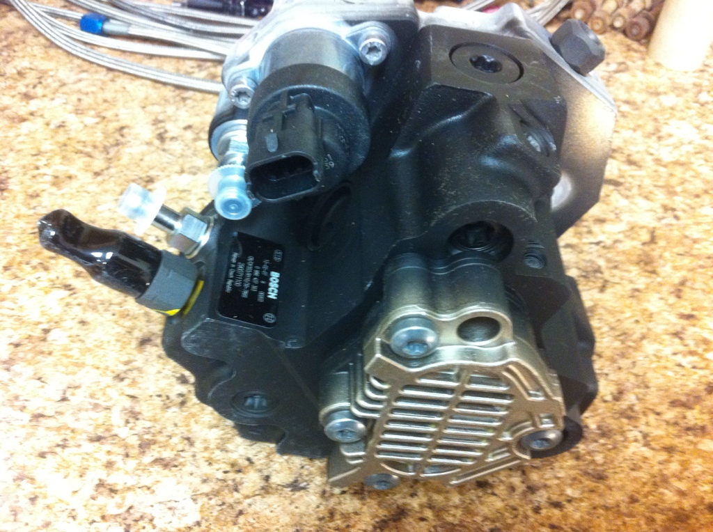

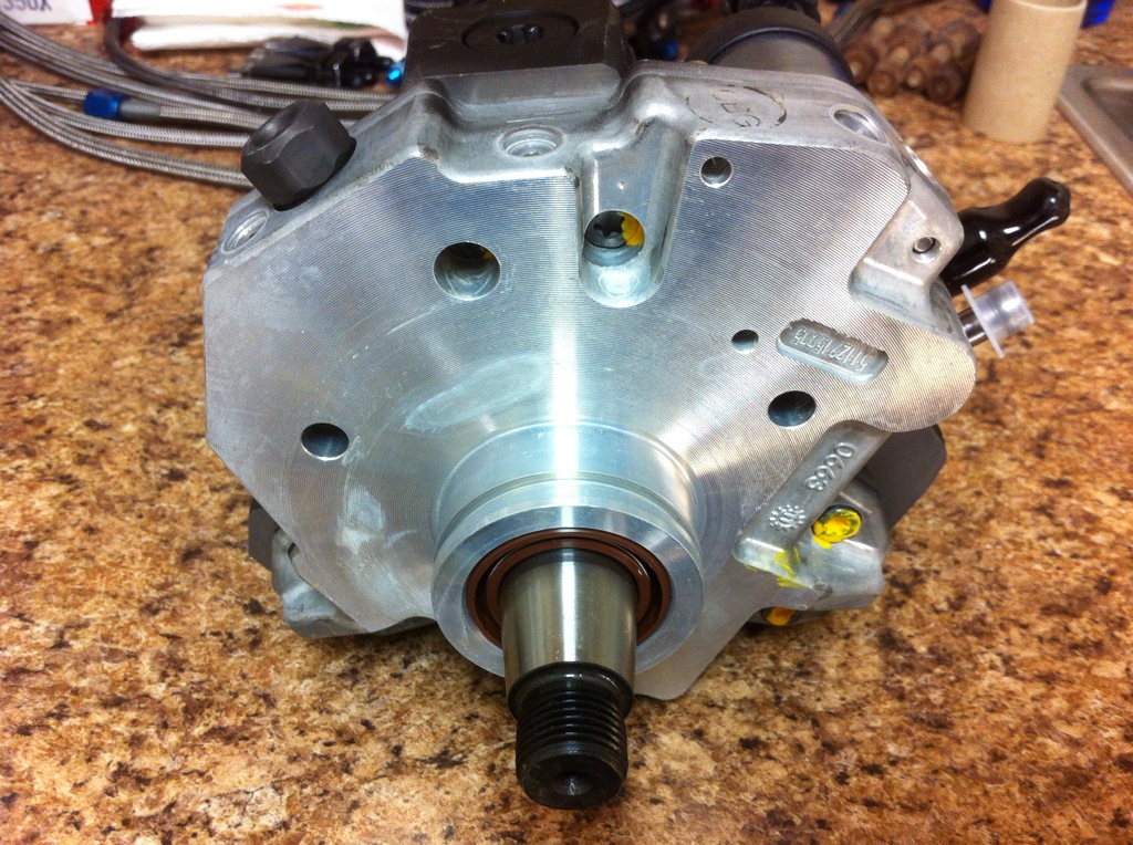

Finally diagnosed the P0093. Weak CP3, and the CP3 return rates were triple the allowed spec. Good news on the injectors though, good balance test, and return flow rates well below spec.
Got this little gem and got it installed yesterday, and fixed a valve cover gasket problem (thanks dealer). Running like a champ now!
