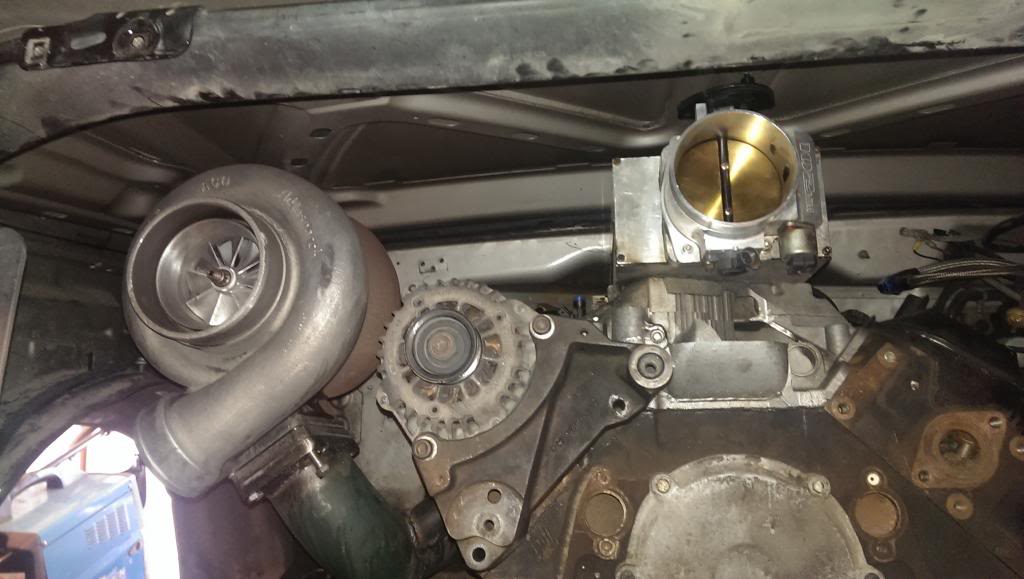

Once i get my ls1 s10 running, back to work on the silver truck. I plan on mild port job stainless valves and bigger exhaust valves on a stock set of heads til i can buy the aluminum extreme heads from you guys. oh and 30 pounds of boost from an 85 mm turbo

I thought the silver truck was running our heads / cam etc??
30lbs of boost! Do you have the forged rotating assembly (pistons / rods / crank)? I know you already know this, but boost + cast pistons can create more problems than its worth!
Let me talk to Larry, but I'd bet if you wanted to pay the shipping, the ported stock heads off the shop Suburban could probably be yours when we put the aluminum heads on the 540. You're probably only going to get another 20-30CFM out of them, and you'll still have to have new seats / valves put into them, but at least it saves you the 10 hours of rust and misery that is grinding down stock iron heads.
You'll still need springs, roller rockers and a boost friendly cam - but you already know who has all that.
