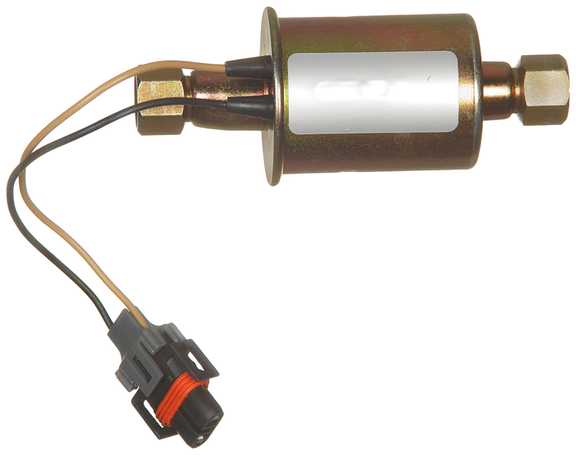

Hey guys, I've done a ton of searching around for lift pump info. I've learned enough to know that I do want a lift pump. But I'm not convinced that I need additional filtration, and 500+ bones on for a FASS or AirDog pump isn't too appealing to me either.
So, on to my question. Is there any reason that a basic lift pump won't work? My truck is stock, and I have no plans to do any serious modding(stock trans) beyond a 30-50hp tune.
Something like this.
I'd wire it to a relay, triggered by the ignition switch. What to you guys say? Am I wrong for thinking like this?

I put the Airdog II on mine. If I had it to do over again, I'd have probably saved the money and just put the Holley "Black" pump on it. Guys say it works good and is still flow through if it's not running or dies on you so the truck will still run with out the pump running.

Yeah roger a basic inline flow-thru pump will work. You just need between 5-8 psi of flow measured at the filter head.
Just need a pump that will work with diesel , I've read about reg. pumps failing with diesel , from the sites it seems the Holley black is hit or miss.
Some guys also build a simple bypass around the pump incase it does fail.
You will notice a much stronger running truck with a lift pump, and no more pumping the plunger to prime it after filter changes .

I put a holley black pump on my truck 3 months ago and also added a napa filter head with a cat filter with the 2 micron rating. I made it in a way like the airdogs and fass setups. I can tell you that it made the truck more responsive. Plus its always a good thing to have the better filtration with the injector issues.
