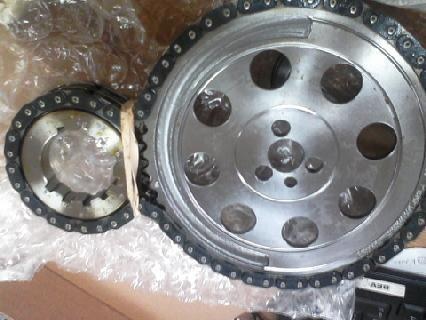

Here's a Crane timing chain. Name:  image.jpg
