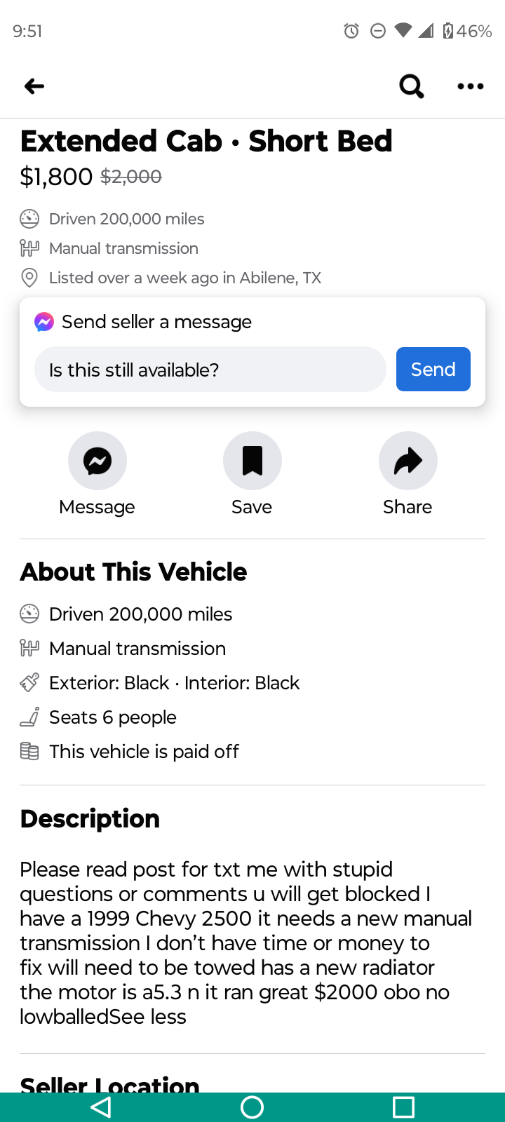

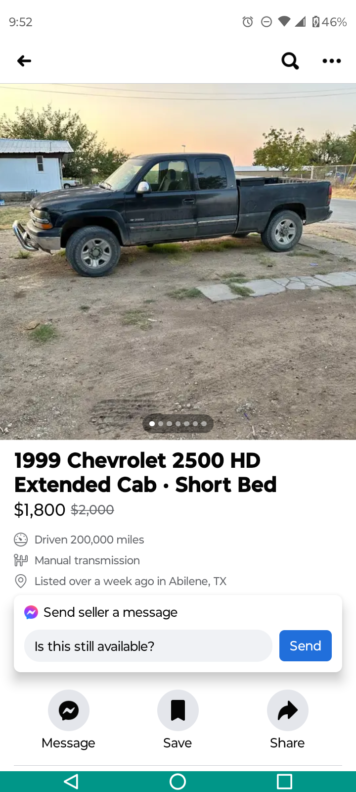

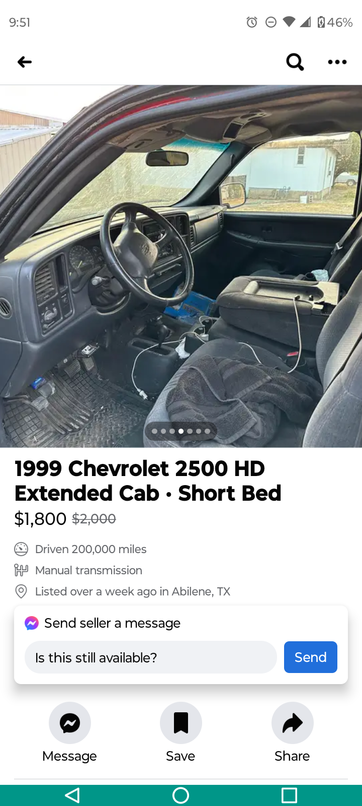

1999 Silverado 2500 4x4 with a 5.3, manual transmission(?) and I spot a full float rear axle. 🧐
https://www.facebook.com/marketplace/item/1932144027168886/?mibextid=dXMIcH
Edit: link is not working... here's some screenshots:

See if you can get a vin number so we can Validate it.

The last 8 would alow me to call the dealer and have them look it up. They can pull up the RPO Codes.
It's always good to have the full vin to verify though. With as old as they are now, I have seen alot of goofy stuff swaped around.
It could be legit, but It could have been a 4.8, 5 speed that some one put into a 2500 chassis. Or maybe it was a 6.0 truck and they swaped a 5.3L in, It could be a body swaped truck.... Anything is possible now a days... Like why does it have a floater rear end? all the early regular 2500's I have seen had the 9.5 under them.

I also noticed the engine bay is red but the outside is black! 🧐 Maybe it got a Rust oleum color change!
I messaged the guy. We'll see.
I'm pretty sure on the gmt400s the C/K2500 8 lug with the SBC and manual got the full float 14 bolt; otherwise they got the SF with the auto. And with the BBC/diesel they also got the full float regardless of transmission. So maybe it was related to that? 🤔

Yes, some one repainted it. The cab is the same way if you look in the door jamb photo
