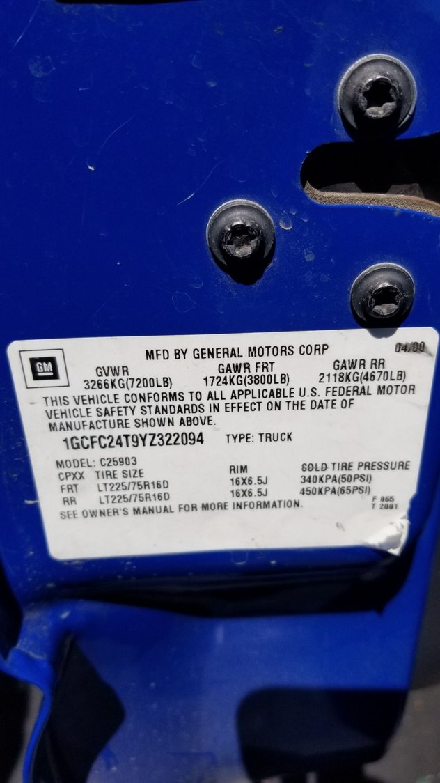

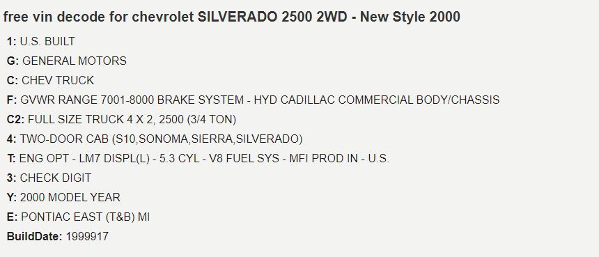

FOUND IT!
Here is a standard 2500 regular cab long bed with a factory 5.3L/4L60E combo. This was a US market 8 lug truck. Not a Mexico Market 6 lug 2500
1GCFC24T9YZ322094

Originally Posted by arthursc2
At least it had 4.11's
Right!!!
That Color is called Michigan Blue and its another Odd choice you never see listed any where. I am wondering if these were some type of special Fleet Truck.

could be a clone, but the VIN would put all this to rest:
  • 6th digit = class (1: 1500, 2: 2500, 3: 3500)
  • 8th digit = engine (U: 6.0/LQ4, T: 5.3/LM7)
  • 10th digit = year (X: 1999, Y: 2000, 1: 2001, 2: 2002)
