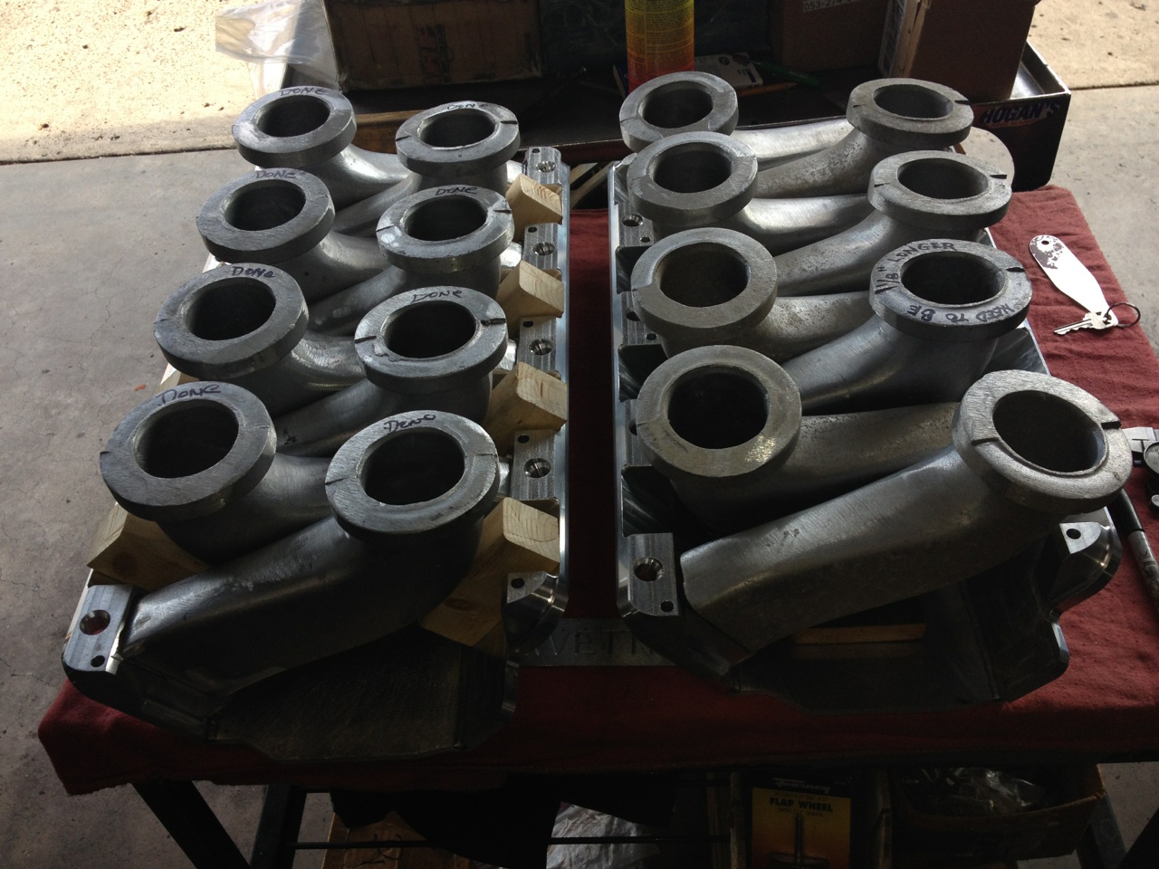

The heads are just lacking the final polish and touches. Still waiting for flow numbers. Raising the seats yeilded chambers that are 107.4cc's. With the dish pistons I found my static comp ratio is 10.6. The block is still waiting final hone. It seems his SBC set up is still taking the front seat until there are several more BBC's to make the change in the machine. My new cam choice is a custom grind from Comp cams having a .715 gross lift and durations of 258 I and 263 E @ .050. T&D is currently engineering shaft mounted rockers for me to fit Larry's Profiler heads and I also have Crower working on them as well. We'll see who finishes first. ARP is making custom studs for me to go deeper in the castings on the exhaust side. Not much can be done on the intake side but with the shaft mounts it should all lock together. On the induction sid eof things, I successfully twisted Larry's arm and he's close to having the lower section completed on the individual stack injection manifold from his favorite engine, the HO 750. I will not have any problems getting air into it. Hopefully I don't have to have anymore custom parts engineered and made.
