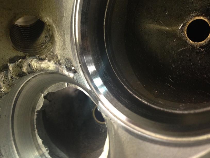

The heads are are still on the bench with my machinist. The new seats are in and roughed, the chambers are being massaged to unshroud the larger valves and the port work is underway. He hopes to have the heads completed in 2 weeks although I'm guessing 3. The block has been line honed and the decks squared. The 4.610 bore is ready for final hone and the bottom end has been balanced. Unfortunately he's 800 miles away. I had to leave them as a job transfer took me by surprise. I'll see if I can get him to take a few progress photos for me.

I fianally made it down to see my parts. I thought the heads would be further along, but... The new seats were raised to help with the blending/porting of the chambers. Hopefully since these were taken the port has begun. With the lift/duration and required spring pressures of the new cam, I will be going with an adjustable valve train and stud girdles. Thankfully, ARP makes a metric bottom SAE top threaded 7/16" stud for these heads. Comp Cams Ultra Pro Magnum Rollers and some vendor to be named later anit-pump roller lifters will go in. This combination should let it rev to the 7k mark with no issues.
The block was sitting on the floor waiting for the final hone to 4.610. There's a shot of the Ross racing pistions are being sent out to have the skirts coated. These pistions have a 20cc dish that will depending on the final cc's of the chambers will land the CR between 9:2 and 9.4:1. Beacuse of the dish I had to go with the 6.660 lenght rods over the 6.800's i wated to run.
As the machining continues I'll post some more pictures.
