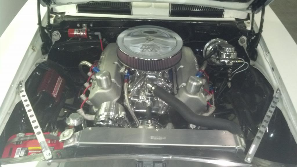

This beast with a 468 big block

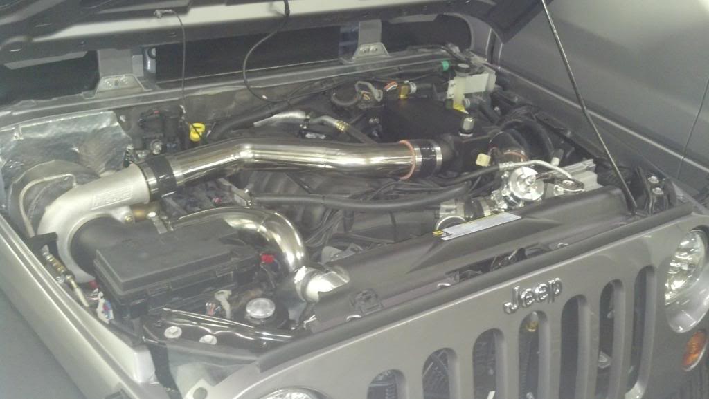

This thing is sweet as hell, Jeep with a 6.4 and a PT7675

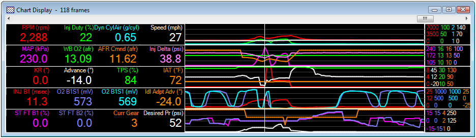

So, no further progress on this thing. Plugging in the ABS sensors in the rear got rid of the REP mode, but everything else is still jacked up. I think it is due to incorrect throttle feedback, though. Commanded throttle position is much higher than the actual indicated TPS (both sensors) despite the throttle behaving as it should physically. For example, if I have my foot to the floor, the throttle is fully open, but TPS only indicates 39%. This results in a delay in PE and a whole slew of other problems. Far as I can tell, its eiher wiring or ECM. I got a video of it...
Ideas would be much appreciated.

Its going to be a beast once I get this throttle **** figured out...
