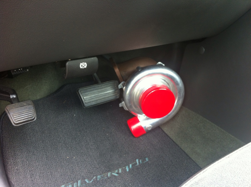

All wiring is good. Cycled key on and tossed a turbo on the gas pedal to keep it wide open
I then then up and tugged on all the wires, wiggled, pulled, etc and the blade never budged. All wiring seems good, Throttle blade isn't held up on anything either.
I am thinking the blade is seeing flutter or else not open to the full 100% as mentioned, maybe back down the peak %, next step. If that doesn't work I am getting a 4 bolt to 3 bolt adapter and tossing the stock TB back on this thing!
