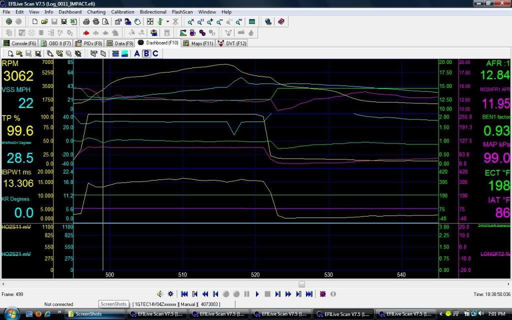

I have been messing around with the transient/dynamic settings... I noticed that with stock settings it would go WAY rich right at WOT.... So i started messing with the settings...
From my logs Impact Factor WOT (B3407) is the amount of air right at the throttle transition, a large amount of air translates into a Rich AFR... A higher number in this table means more air (more air means richer mixture). The Evaporation Time WOT (B3403) is the duration of the shot of air, meaning a how long the initial burst of air sticks around. A higher number means it will add more air over time, smaller number means less air over time...
The pics should explain themselves...
In all the pics i have the line on the rich spot at tip in...
Stock settings.

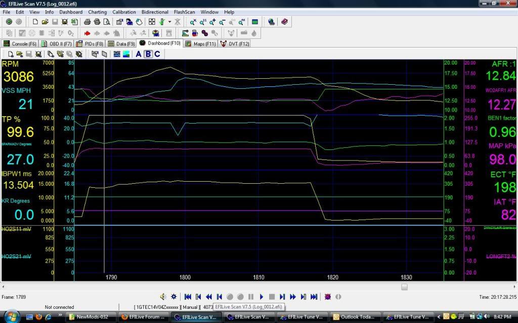

Next i increased the Impact factor WOT by 25%, notice it goes richer

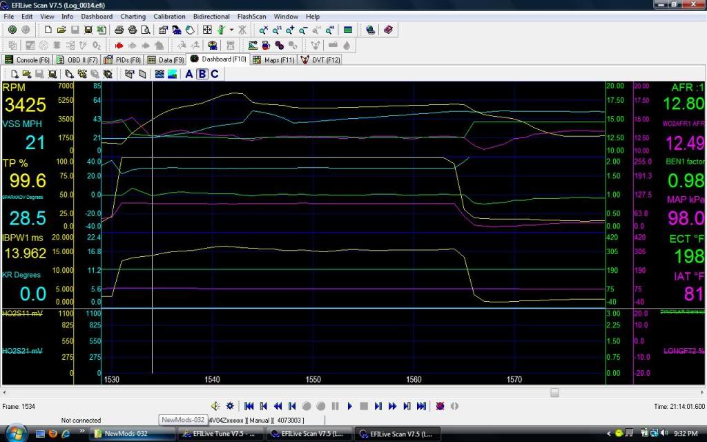

Next i decreased the impact factor WOT by 50%, notice the AFR...

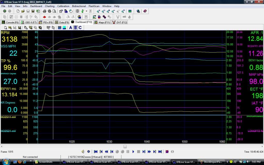

Next i decreased the impact factor WOT by 25% and increased the Evaporation Time by 50%

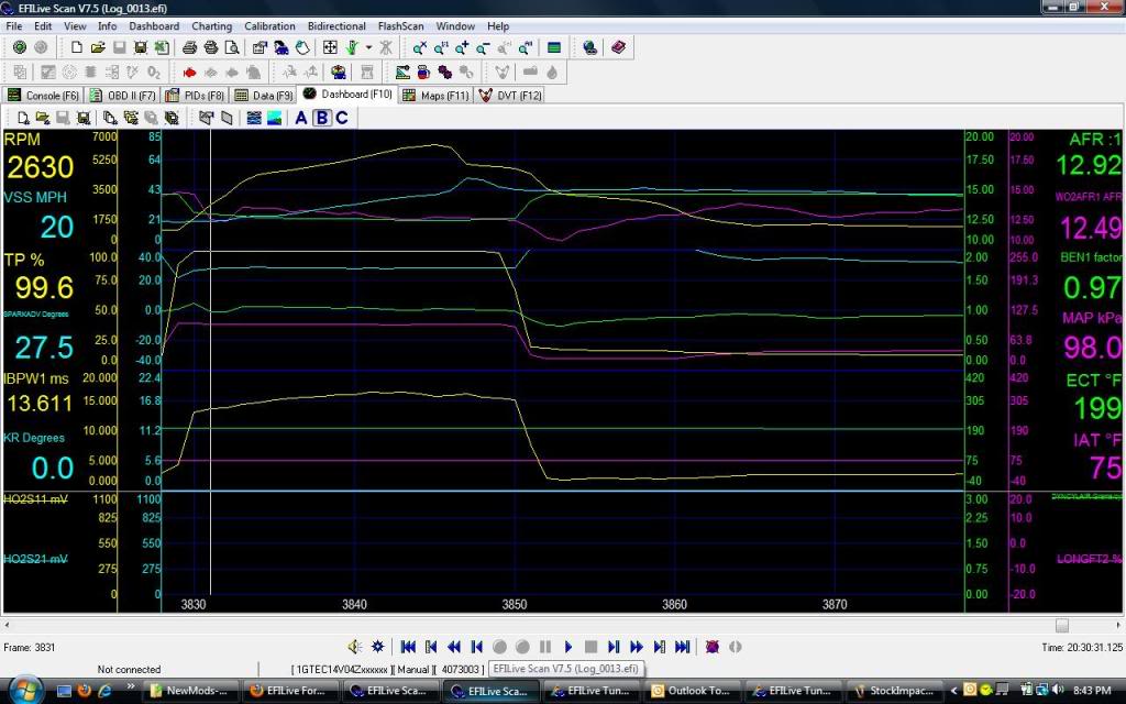

Next i decreased the impact factor WOT by 40% and increased the Evaporation Time by 50%
