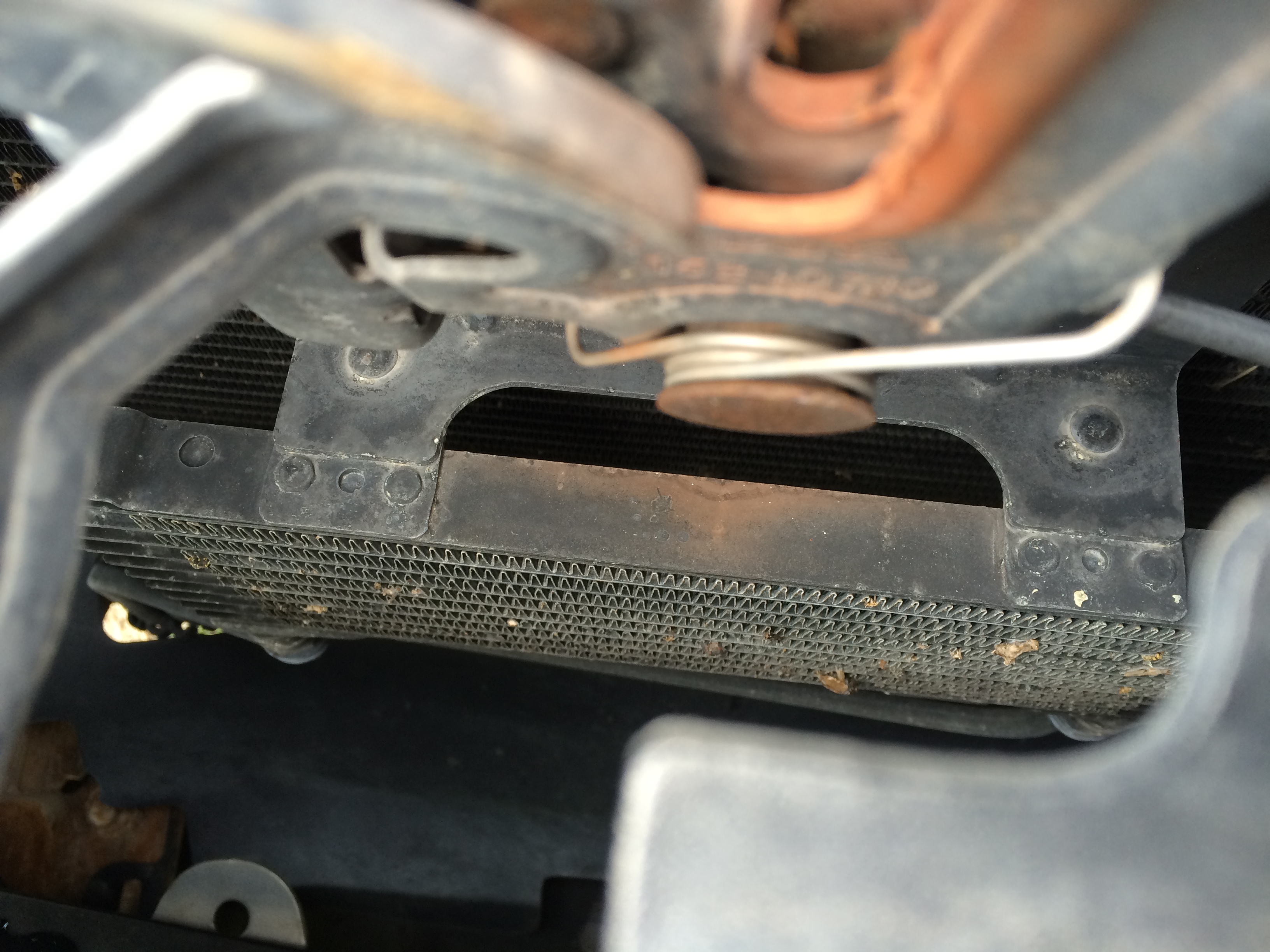

Do you have an external cooler on the trabsmission or just running through the radiator integratted cooler??
Old Jun 4, 2016 | 01:02 PM
  #55
Furdkiller's Avatar
Joined: Mar 2016
Posts: 143
Yeah it has another transmission cooler.

Did you flush them out before you installed the new converter?

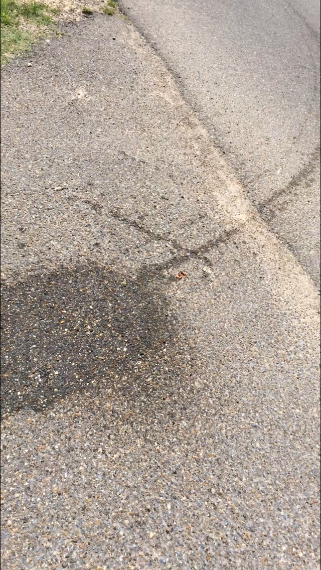

This also happened two weeks ago, transmission was leaking. I took it back he "fixed it" drove it home and then all of this happened. It wouldn't move so I had to wait all weekend to take it back to his shop since he closes on the weekends. I take it Monday and I get it back on Friday, and I drive home and on the way home I get the transmission hot warning sign.

Beacuse they are pulling air across the cooler, which pulls the heat out of the cooler and fluid in it...
