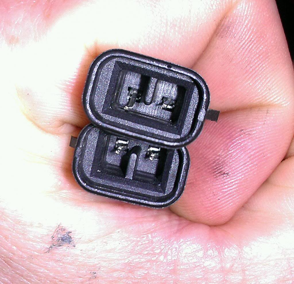

Well I found out what my issues were. After I took a laser temp gauge to the exhaust manifolds I found one only reading 225F where all the others were close to 500F. After some simple test I found this on the injector pig tale for that cylinder. Bent pin.
Second issue of not logging STFT LTFT, well I just had to turn on the "fuel learn" on the scanner and I got it working.
