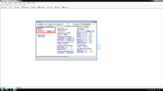

Here is how you turn off the Open Loop Fuel Trims.
Sorry, you have to open up the photobucket page to make it big enough to read...
