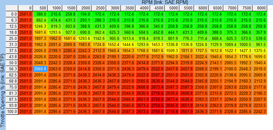

How does your c6101 ETC table look like? how much % did you add? i did have a lot REP i solved them by modified the table like this.
Attached Thumbnails Reduced Engine Power mode please help-efilivecapture.png

I have increased C6101 before with no luck. I am actually waiting for the weather to clear so I can see if B0120 helps. I am crossing my fingers hoping that was the problem with my LS7 TB. I should be able to.run it tomorrow.
