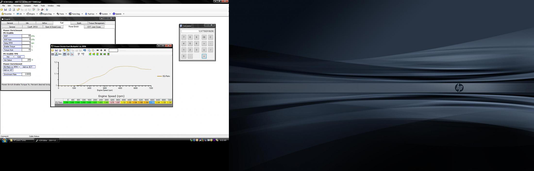

Okay, I think I've got the hang of it - let me know if this looks a little more in line (see attached).

Old Jun 9, 2011 | 11:55 AM
BlackGMC's Avatar
Resident Retard
iTrader: (31)
Posts: 17,216
Likes: 20
From: Fort Worth - TX
Well the way i have set mine up is the inverse of the cylinder airmass. Meaning as your grams/cyl goes up you richen up the afr and vice versa for when it goes down. Basically what everyone else was generically saying. Your fattest point should be at the highest grams/cyl. Same applies for fi. Very simple actually and it is not guessing
EDIT:
So if you use EQ Ratio, it would be the same profile as your grams/cyl,
If your using AFR, then it would the inverse of the grams/cyl profile.
