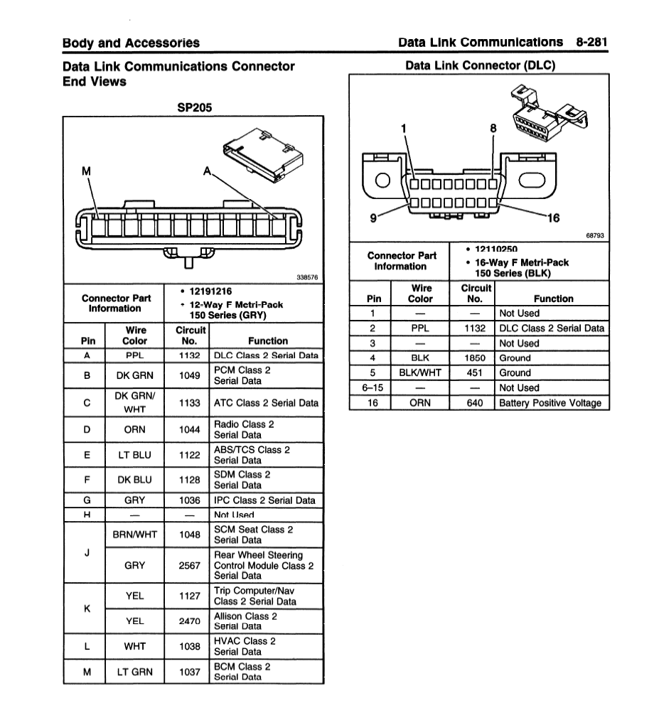

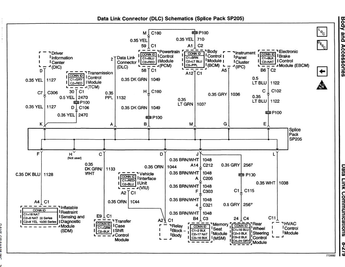

I went back over what I did, and found the problem. When I originally pulled the aluminum covers off the PCM connectors, I pinched one of the wires putting em back on. The covering wasn't broken, but upon detailed inspection I could see it was "smashed", and without cutting it open, I must have cut the thin (what is that 22g) wire. I cut out and replaced the wire, and was able to immediately read with my code reader, and reset codes. All the issues I was having are all gone. Checking my pinout, that wire is a CL 2 serial data.
Perhaps I'll post up the schematics for the CL 2 serial data connections that go into just about every electrical connector under the hood and dash, but you're probably better off buying the PDF service manual, or going back over what you last did. If anyone comes across this searching, my first suggestion would be to go back over the wires at the connector for the PCM. They are incredibly thin and delicate. If you kinked one you may have broken the few threads inside.

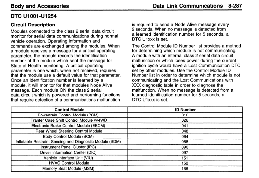

And if you have a several thousand dollar + scanner, (the aultel one that does modules is $4k+) it would scan the modules and give you these codes, (which don't help you without it, and it would tell you this if it could).

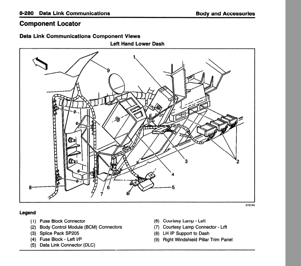

If you are not sure where the connectors are:
