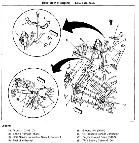

The ground that goes to the driver rear of the block apparently cam off the bolt when I put it on, but I still have 0 reading from the MAF. I don't thing there are anymore grounds but I will go over the engine bay again. How much voltage should I see at the MAF'S pink wire?

pink wire on MAF should have +12V. Try referencing it with the MAF black wire then with the battery -. It it is not there with MAF black wire but is with battery - then you are still missing a ground. MAF +12V is sourced with ENG1 fuse and grounded with G103.

I've tuned thousands of trucks over the past 12 years and never encountered a corroded MAF connection. MAF problems I've seen have always been blown fuse, missing ground, cut wires by other tuners or dirty insides. Did you check the G103 location?
