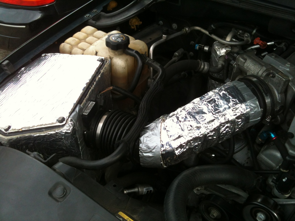

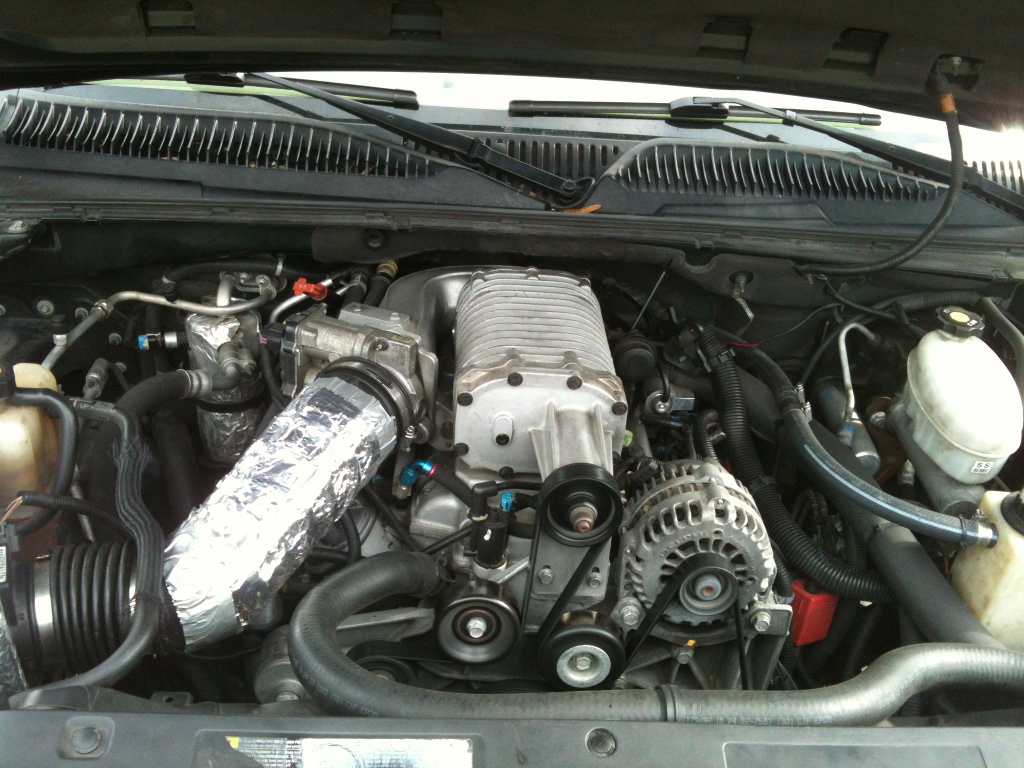

I wrapped my CAI box and tube with simple home a/c duct insulation from Home Depot, about $15 total. Doesn't look great, but my truck isn't a show truck. I noticed a SOTP difference afterwards. Didn't log before or after IAT's, but by theory alone, it should help keep underhood temps out of the intake.

I forgot about that one you did..
ive gotta get some that for my intercooler reservior. i made one out of stainless and its goin to be right there by the turbo
