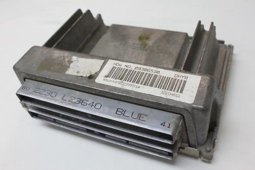

Just an fyi..... In case you dont know...
99-06 nbs gen 3 style pcm
07up gen iv nnbs e38 style pcm
Again would really like to see the magic spell to convert the gen iv harness to work!!!

So now knowing how two different the ecm's are.. Would it be easier to use my stock ecm, adapt my stock harness that's currently on my lm7 to work with the gen IV motor? Besides knock sensor ext. , cam sensor ext , and injector pigtail adapter, what else would be needed? Do I have to remount any sensors?
