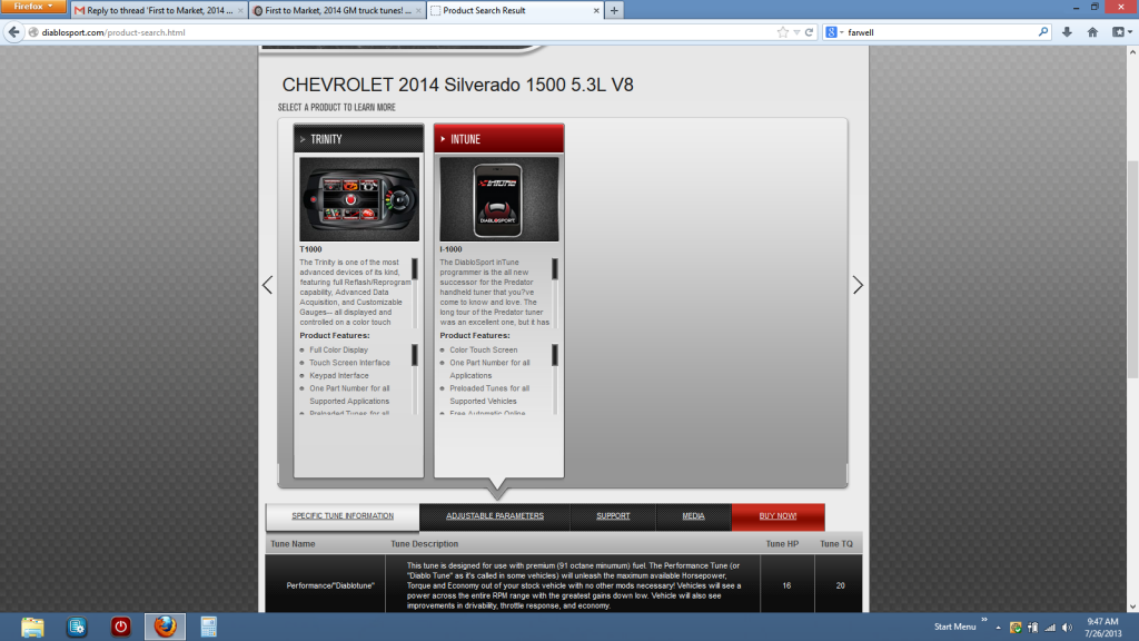

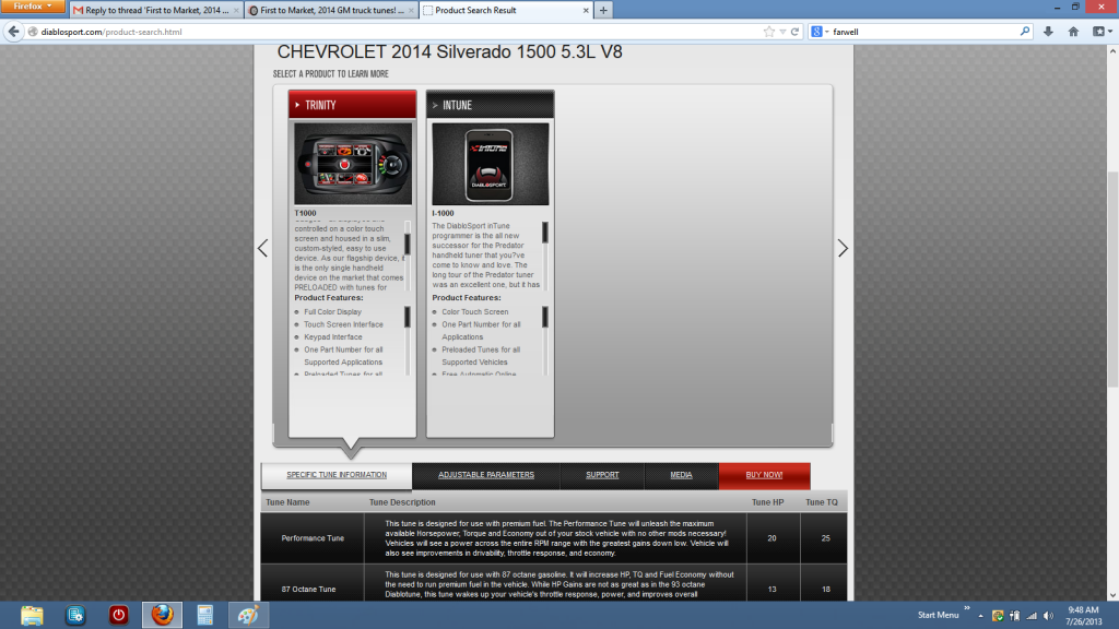

Originally Posted by CodyG
Mike why does it show to make 20hp/25tq on the T-1000 and 16hp/20tq with the InTune?
Where did you see that?
Gains are indeed the same on both tools

Notice the HP/TQ numbers different between the 2, this is why I asked I figured it was inaccurate.
