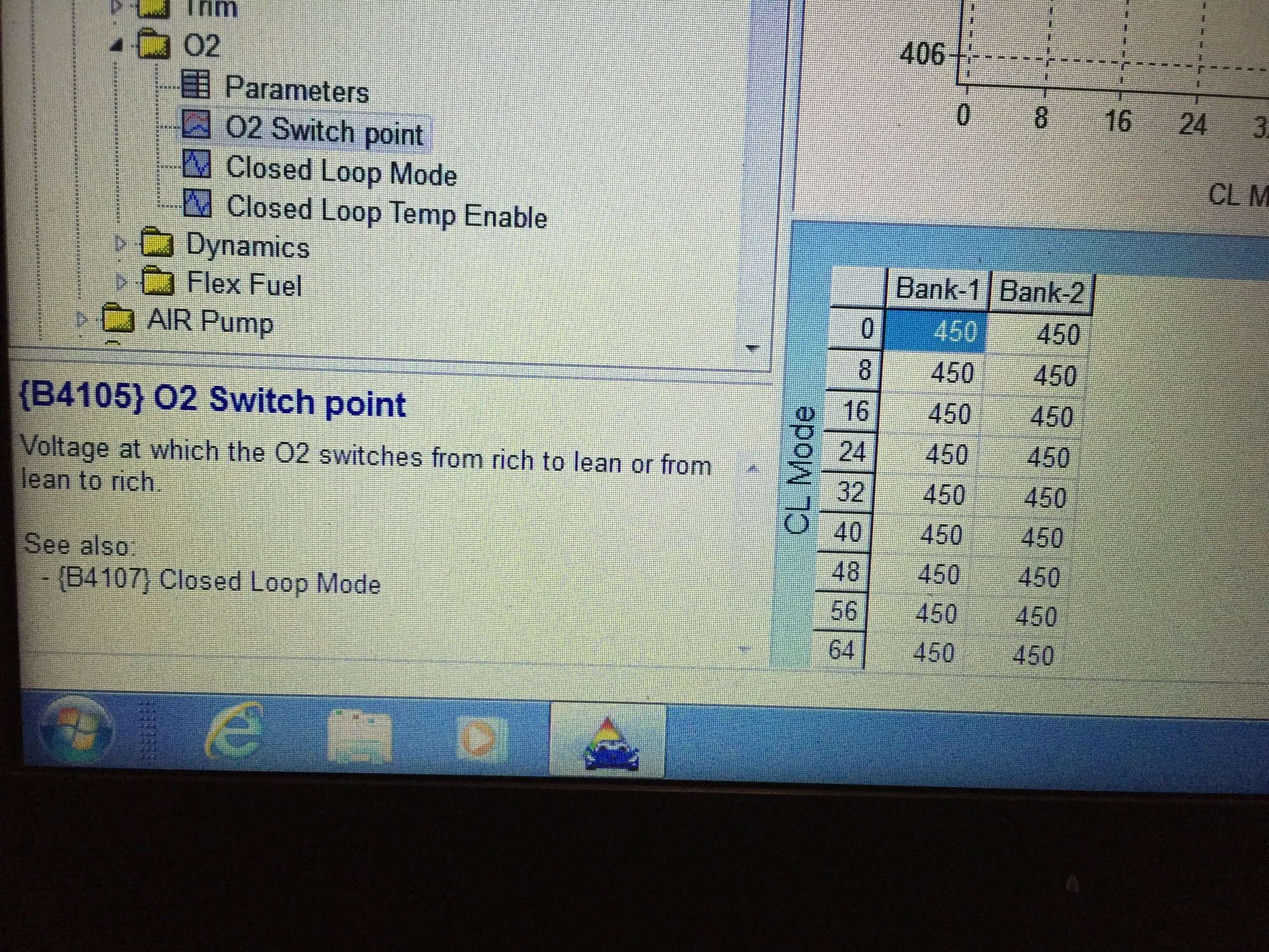

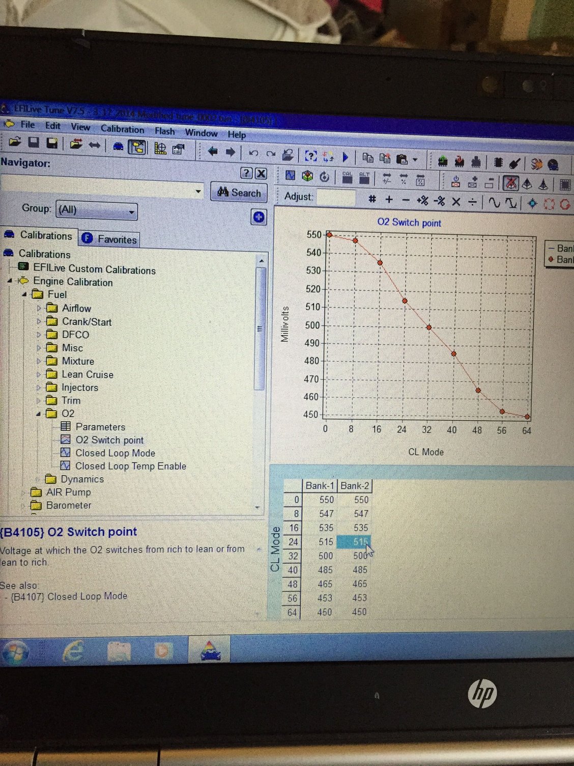

Also I noticed this- between his tune and a black bear touched tune-
why different voltage? im learning FYI
Black bear tune- don't know if he did mode this
why different voltage? im learning FYI ​​​​​​​
I'm going to explain this in the way that I understand it.
Expect anywhere from 0 mV to 1000-1100 mV being generated from the O2 sensors during operation. If I understand it correctly, the higher the voltage the more 'rich' the mixture is. The values that are being changed are the switch over point that the ECU calls rich or lean, one or the other.
So 200mV would be lean, 750 mV would be rich.. the ECU switch over changes fueling strategies and the point in which the ECU begins to switch the other direction, so moving these values to the higher side of the switch over moves the overall mixture richer.
Make sense? Hope so. That's how I understand it anyhow......
Try logging the o2 sensors and watch them react as you drive the truck, perhaps it will make more sense after you see this in operation.
This can also be used as a troubleshooting tool, if you find a sensor that is lazy in comparison to its brethren you may want to change it out as it is beginning to fail. O2 sensors typically provide very quick responses and are always changing, they don't stay stationary like temp sensor would and if one is significantly slower than it's neighbors you are probably not getting accurate readings from it, or at least not as accurate as it could be.
correct! That's how I see it to. However between the two tunes why are they different that's what has me interested. I need to get some time and read that link about 02 switch points. Thanks for the help btw
