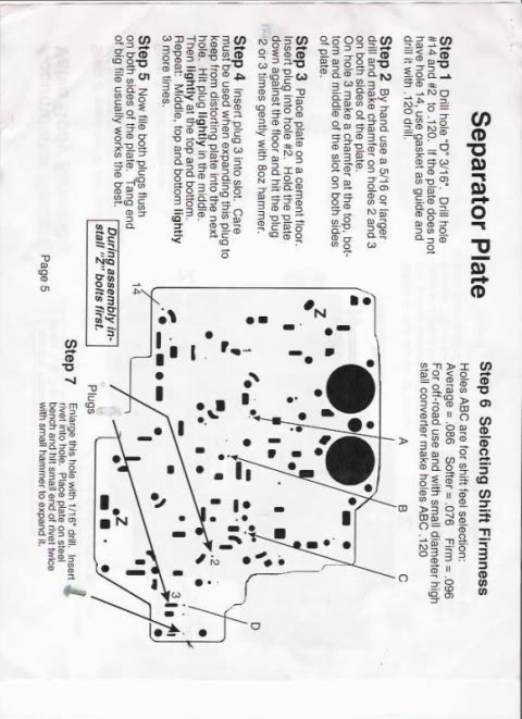

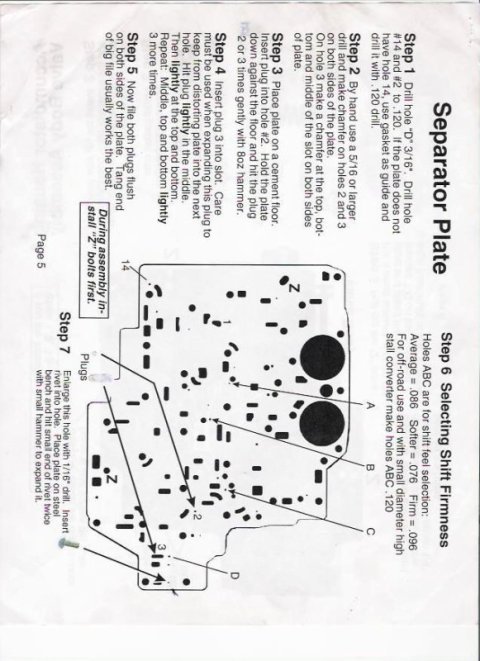

I have the TransGo instructions on how to do the plate if you need it I can post it up , as gmforlife said the valve body is right under the pan and the plate under that , a new plate is only 25 bucks , some 80Es had aluminum plates , and most will switch that out to the steel plate .
