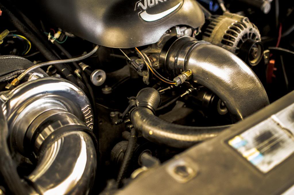

black and orange same as the wires the sensor comes with
