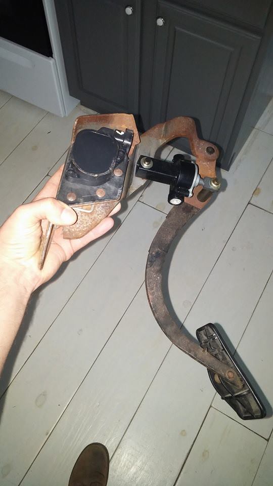

While we're talking about pedal assemblies, what year truck is this pedal assembly out of? Anybody recognize it? It's said to be out of a 2003 Silverado, however it doesn't look exactly like the stock pedal assembly in my 03 Sierra.
That's one of the adjustable units from an SUV.

Oh! I had no idea what the additional 'adjuster' was for. I guess someone had swapped that into the Silverado it was pulled from. Thanks FastBrick!
