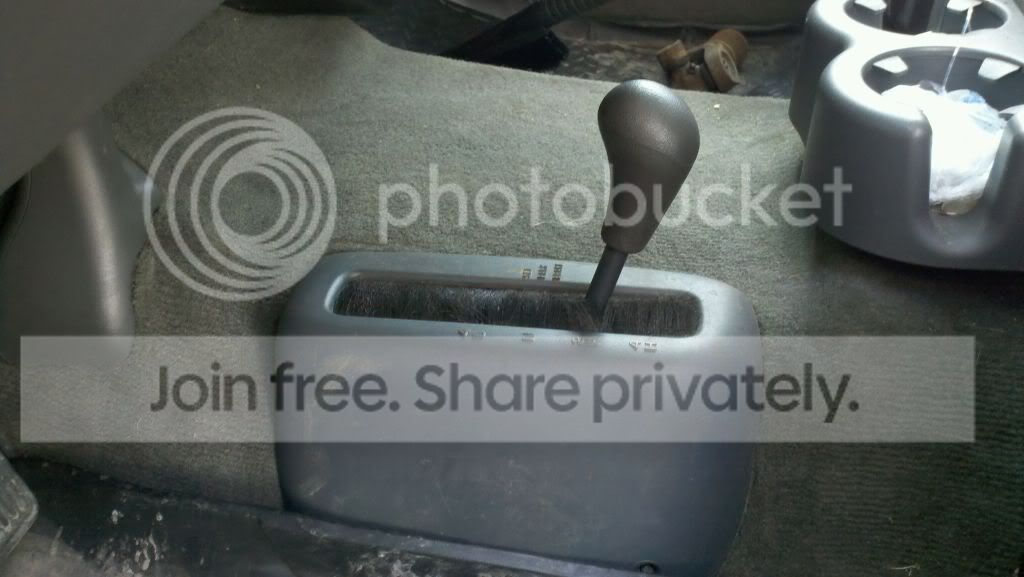

The best solution:

Originally Posted by Atomic
The best solution:
Except when you're strapped into your corbeau seat and can't even lean forward far enough to grab the shift lever
Old Aug 14, 2015 | 12:40 PM
Atomic's Avatar
I have a gauge for that
Posts: 16,282
Likes: 438
Just gotta slump down a little
