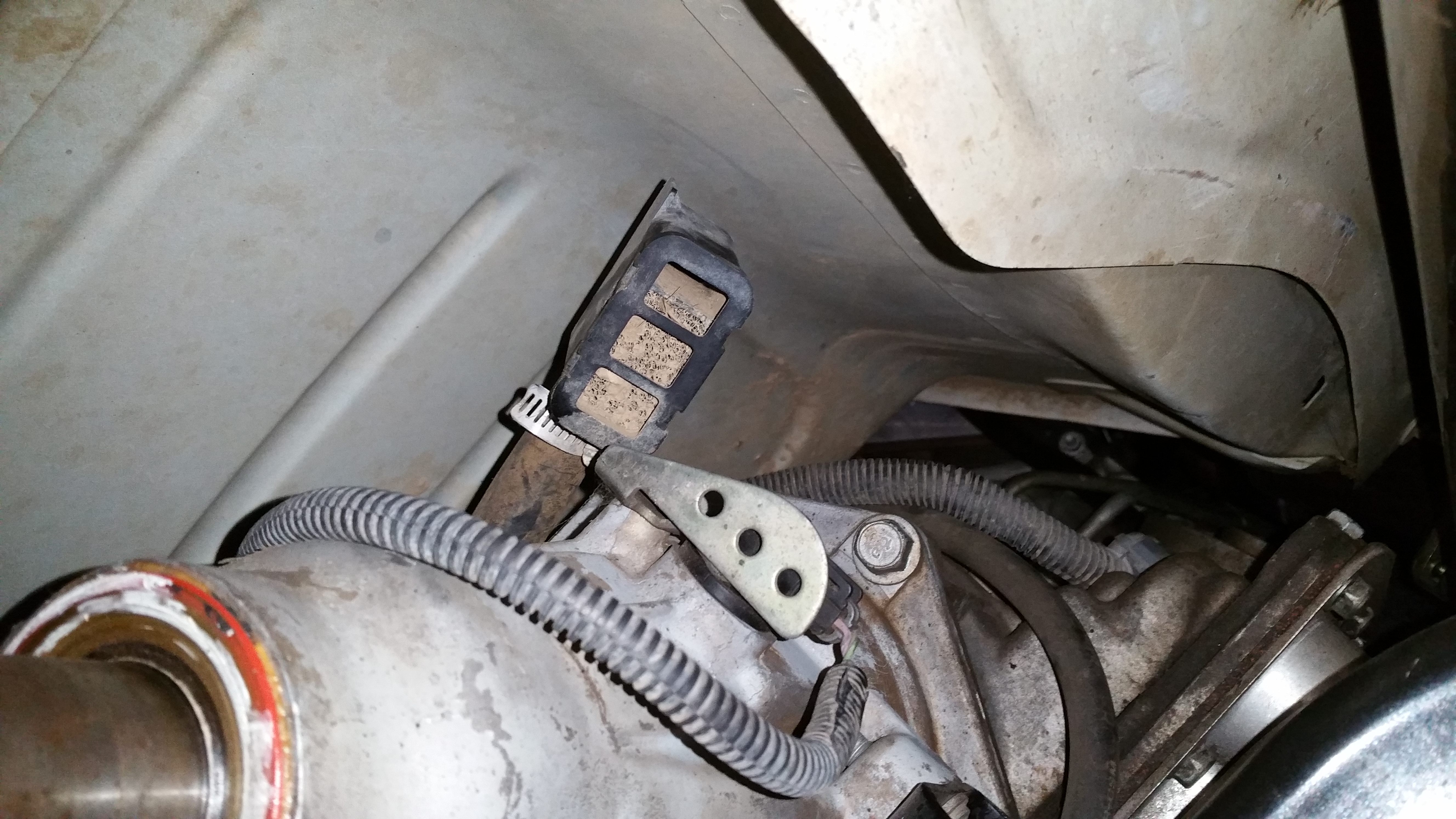

Its on a 03 silverado..I traced it and it'd coming from the evap solinoid

That's just a vent for the EVAP system. They stick them above the transmission to get them far away from road debris.
Pretty common for those filters to become plugged in some parts of the country.
