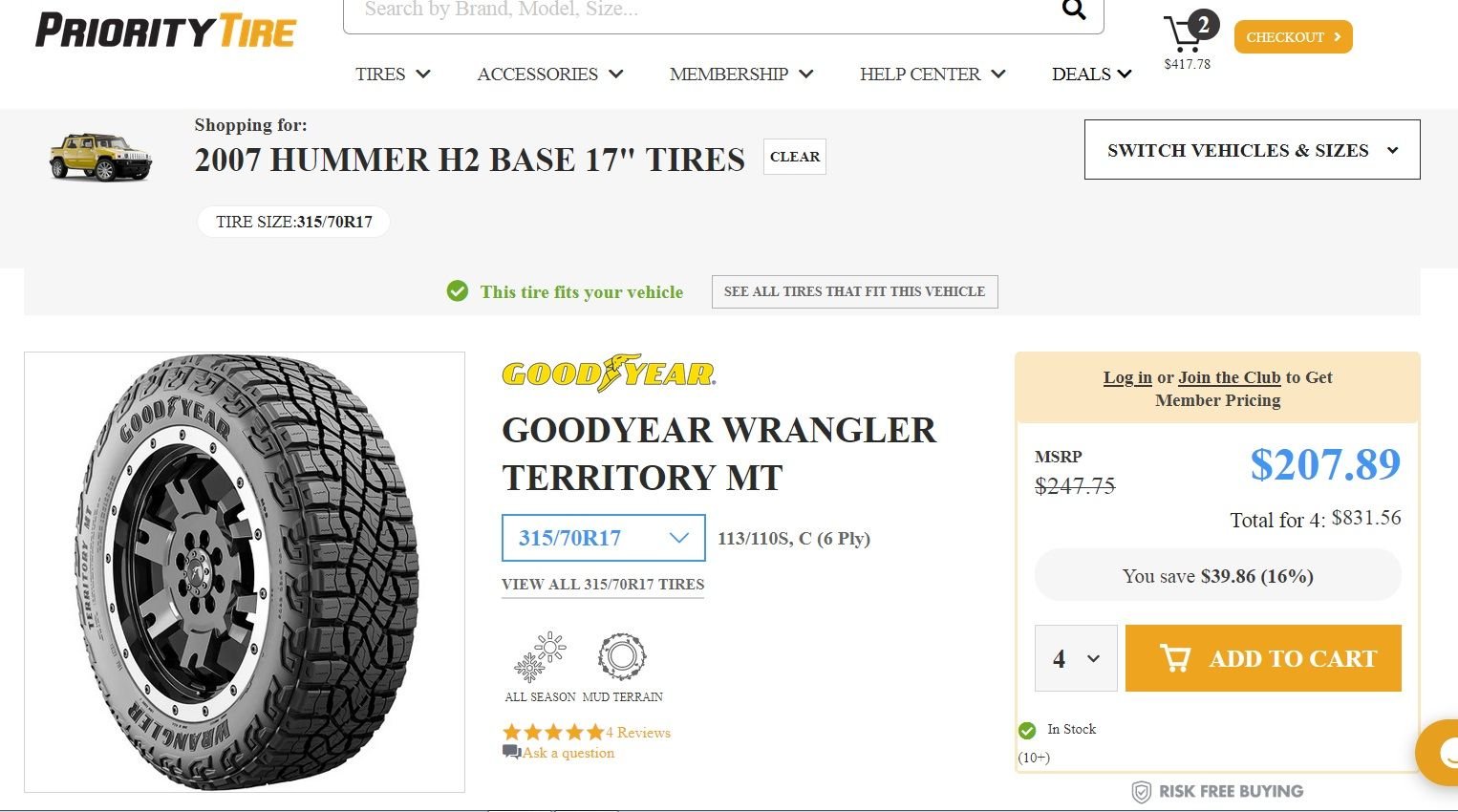

according to walmart goodyears not strong enough apparently the load index needs to be 121 could this be missinformation. or is walmart just as delusional as amazon on what parts fit? priority tire a fakebook sponsor seams to think there strong enough for H2.H2 weight 6400LBs. will be towing 3500LB Ocean cruiser which includes the trailer.
look the weasles at priority even stole the image from WM.

Load Range C on a vehicle that is supposed to have Load Range E
Wouldn't do it. Is it strong enough? maybe.... just barely
D at minimum, but heck- you do you
H2's are AWD, do all 4 tires. Don't do 1 axle at a time

The load capacity between a C and E is like 700-800lbs give or take. The Hummer isn't that heavy but usually you'd stay with an E rated tire. I've seen people put on C rated tires but they don't last as long and many places won't install them unless you know a guy type thing.

Definitely D rated minimum but that's a heavy 3/4 ton truck basically and they should run E rated, especially if you are towing a decent weight, which I would say mid 3k pounds is.
The E will ride a bit rougher, but it will be stiffer and much more controlled feeling, especially when towing when you don't want a bouncy ride/tire.

That's the stock image from Goodyear that everyone uses. Not sure why that means Priority Tire are weasels.. other than it's not enough tire for your truck.
Tire specs exist for a reason, load range/load index are pretty important specs.

that said, look at the driver's door jamb sticker - it'll tell you the minimum load rating required (i hadn't checked an H2 since they were new on our dealer lot, but 121 sounds like a realistic expectation). most shops won't accept the liability of mounting under-rated tires because that increases the risk of a blow-out (remember Explorers & Excursions 20yrs ago?).
