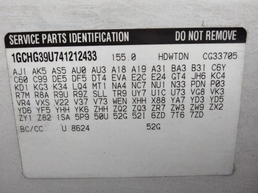

I believe I have 3-73 gears w/ a10.5 14 bolt full floating axle GT4 Axle Rear (Dup of 5X1) 3.73 I think is LSD not sure what Dup of 5X1 is, images of options code and similar axle minus the drum brakes.thanks
