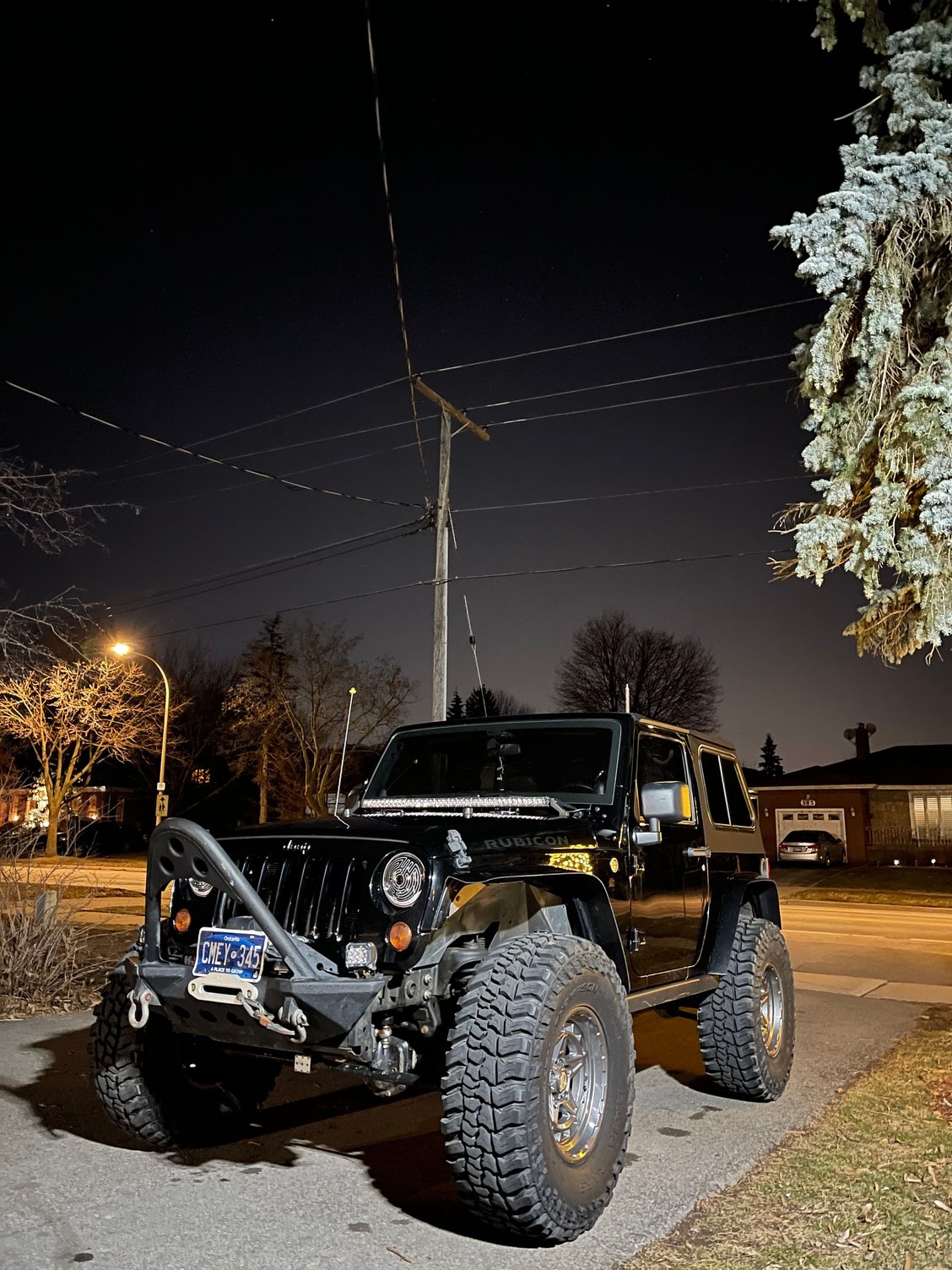

Hey guys, I’ve started a build that seems isn’t as common as I thought. I’ve got a 2011 2 door Jeep Wrangler that’s getting up there in milage (300k km). Currently has the stock 3.8/42re drivetrain, 4.10s and 37s. It’s driveable but anything over 80kmh and it really struggles. I’ve recently picked up an 03 LQ4 that will be paired with the 4l80 adapted to the stock rubicon tcase.
Posting here rather than the car forums because I have similar requirements to a lot of trucks. I need low end torque and reliability. I’ve compared trans gears between the 4l80 and my 42re, they are very similarly geared. On the highway I usually sit at 1600rpm@100kmh and 1900rpm@120kmh. Normally that would be great for milage except my 3.8 makes 200crank, it literally cannot push itself down the highway. I don’t plan to regear it because I’m very happy with the rpm range while driving and it wheels great with the 4:1 rubicon tcase.

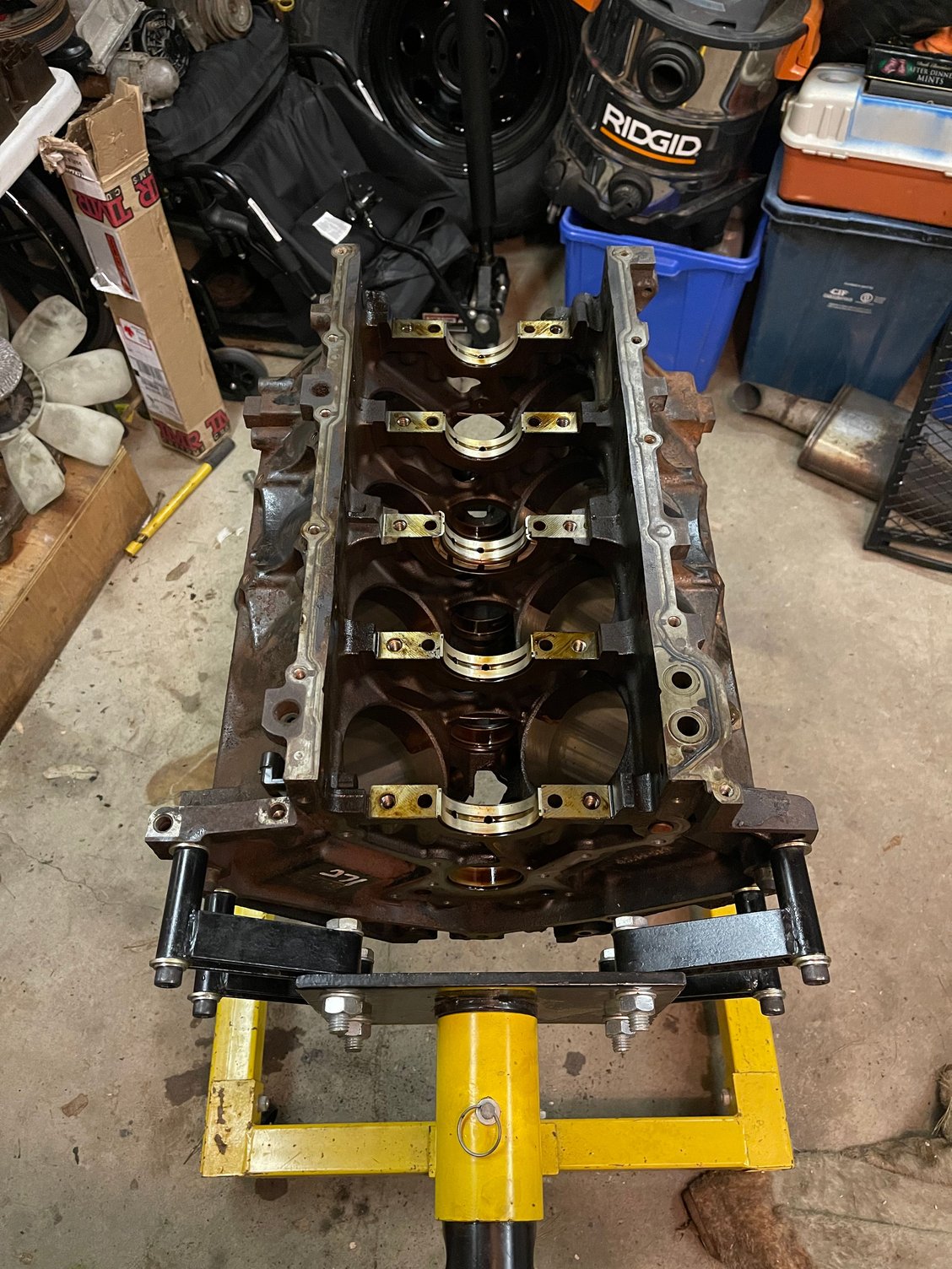

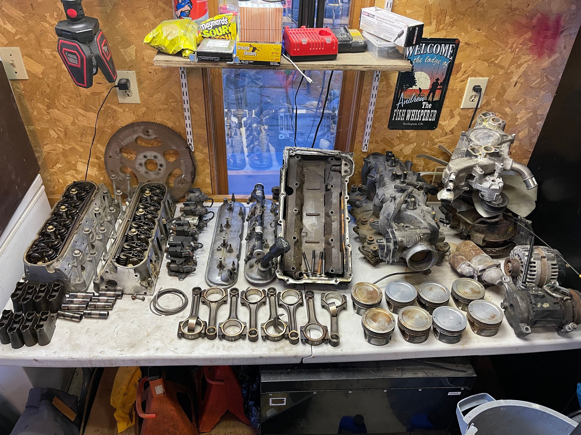

I’ve added a couple pictures for reference. I’ll be taking the block and heads to a local machine shop to be hot tanked and decks checked and potentially resurfaced. It’s a low milage engine in great shape but sat for 10 years. Fired right up and ran great with some fresh fuel before it was pulled.
So I’m looking for recommendations on how to rebuild this engine to meet my needs. I’ve done some research on cams and it seems the biggest I would want is a 212/218 0.550” lift. Looking at BTR stage 2 and ls6 springs. I am definitely open to other suggestions but would like for it to be audible.
I’m still very much on the fence about pistons. Being an lq4 and staying n/a I would like to bump up compression a bit but want to stay on regular 87. Would a set of forged flat tops be worth the extra cash long term? I plan to eventually do heads, intake, and support mods but they will stay stock for now to ensure the swap goes smoothly.

If the pistons and cylinders are in good shape (sounds like they are), consider reusing them. They'll take quite a bit of power. Just get some new rings and gap them for any future plans you might have. If you want more compression you can have the heads milled.

Personally I'd just stick the LQ4 in and see if you need anymore. It's already going to be a TON more power and torque than you've got now.

I’d still throw it back together and run it. New bearings, new rings, deck the heads for some more compression. In something as light as that jeep, it won’t take much to see a huge difference. Not like it does in my k5.
