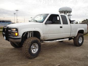

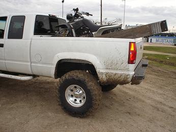

I really enjoyed my pro-comp lift that I had on my old truck. the majority of the lifts made for silverado's are true 4". YOu can of course use blocks to go higher, and ford torsion keys for the front, but blocks are crap. If you're looking for an awesome setup go for the pro-comp or fabtech. The nice thing I like about the fabtech is the ultra-beefy spindles that come with the kits. Pro-comp though has a very very nice true 6" lift. I'll attach a pic of my 97 k2500 i just sold. I will tell you one thing though, if you go with the bigger torsion keys and raise them all the way, you're never going to have a decent alignment. The best 200 bux I spent was on high arc springs from 4wheelparts for the rear that added 1" over the pro-comp true 6, and also ditched the oh-so-crappy blocks. I'll post up some more stuff later when I'm not slacking off from studying.
btw, tires are 37x16x12.50 irok radials, and also there's a complementary pic in there of some nice GForce vettes
