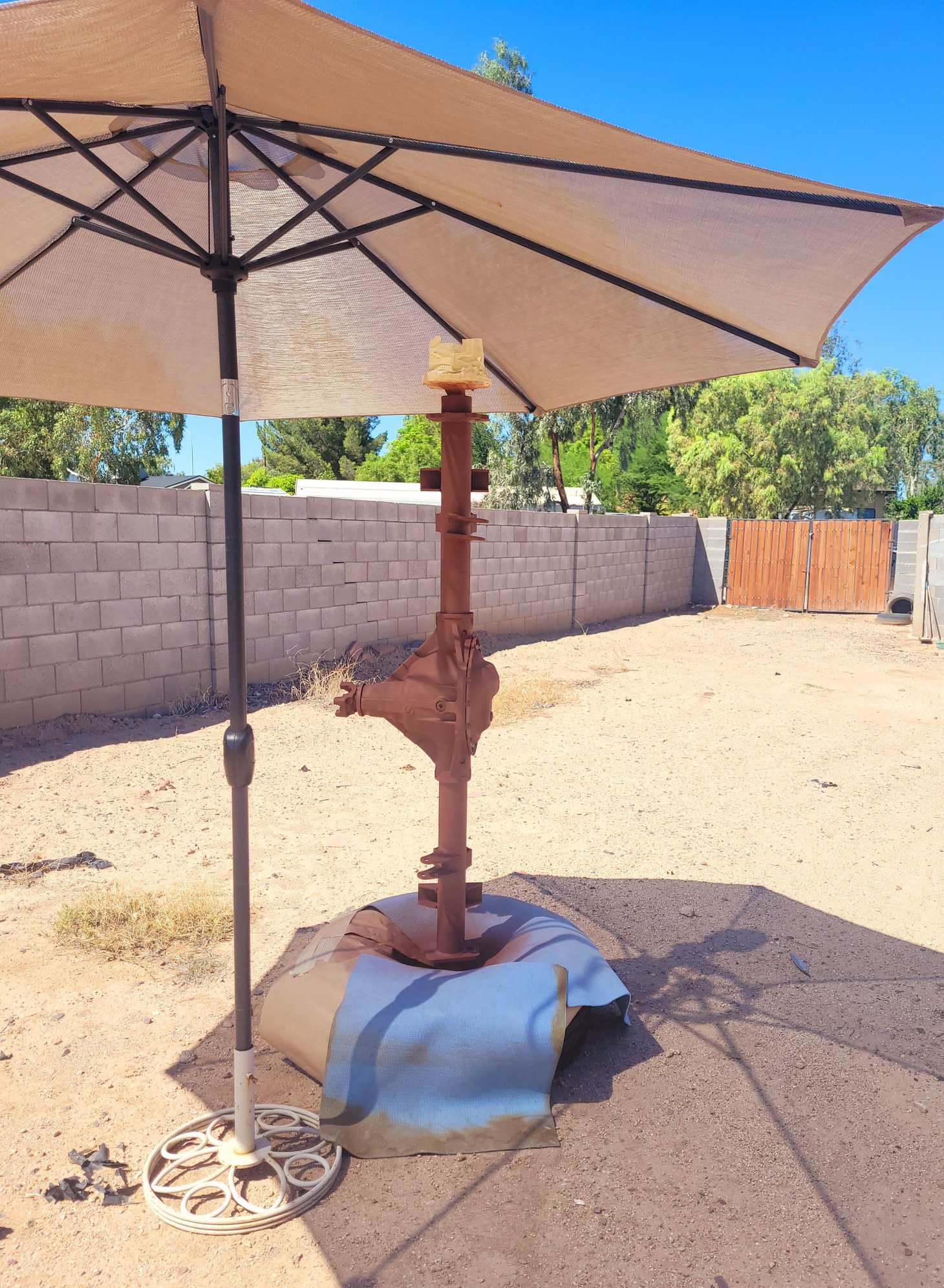

All tabs welded up. Painting in progress. Got the idea for standing it up from another thread. Its soon to be under the truck permanently....... I hope.

I tried using the silverado 2500 backing plate, because I dont have any rear wheel speed sensors on this truck. The silverado backing plates don't have that provision. I could have carved out the center. figured it was easier to just block off the abs sensor hole instead.
Hummer h2 backing plate on h2 anchor.
Silverado 2500 backing plate wont fit the h2 anchor. The center bore is too small.
